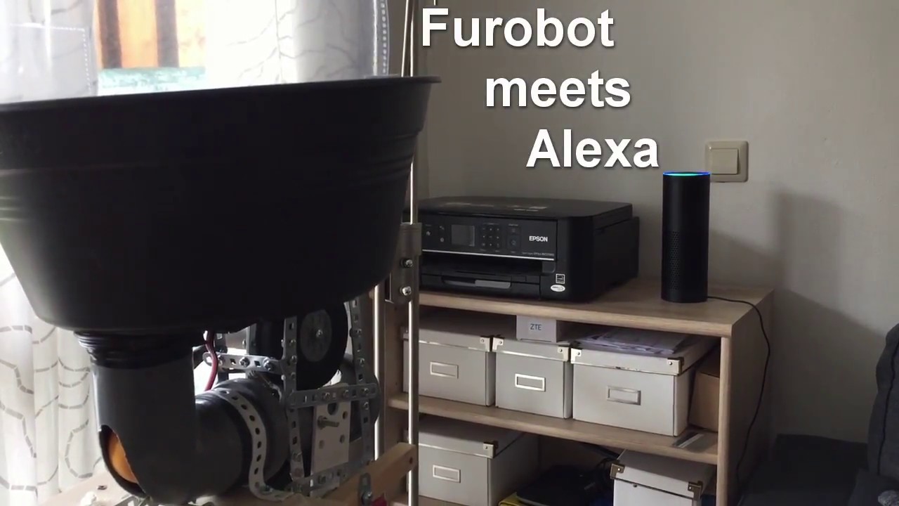

Now, furobot is also enabled to receive voice commands with Amazon Echo.
e.g. Alexa! Turn oscillation on
Alexa! Turn furobot off
How to do it is very well explained in this post:
