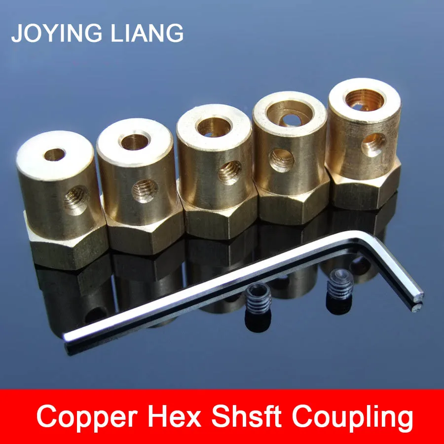

If not mistaken, from the video and photos, the shaft from DC motor are totally round shape and attach to 12mm hex coupler (adaptor) before attach the wheel.

Another questions is, how you screw/mount the wheel with your motor shaft?
I found below 2 types, which one you use?

I have selected the following item with M4 on one side and 3 mm on the other side (there are also other options here).
