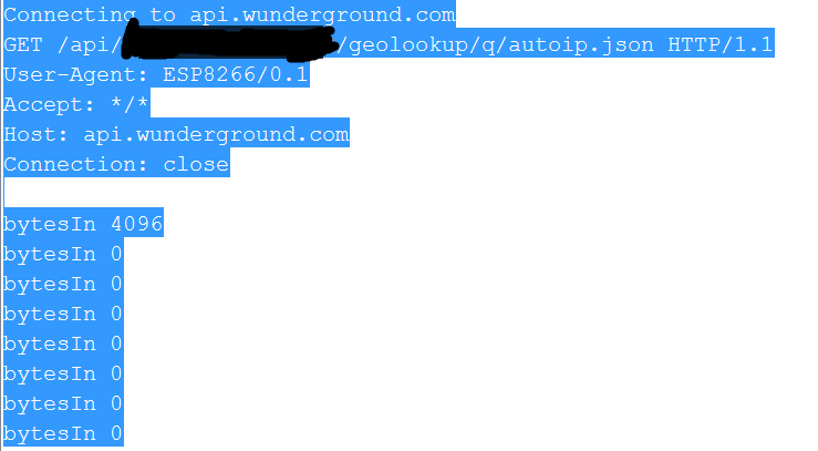

So, i have this running with wifi manager connecting to wifi,but after wifi is connected all i see is this and it reads bytesin at an extremely fast rate. i can post code if that helps. I tried to go through your code and use the important stuff, i wont be sending this data to blynk so i took all of that out to get this part working solo. i also dont need to call it but one time because i only need the initial longitude latitude coordinates. then i wikk connect to blynk and do my other stuff/
Well that first line looks promising… not sure why the rest is there.

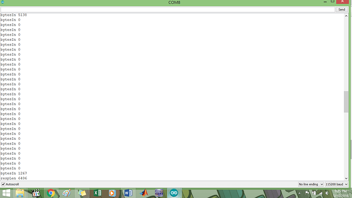

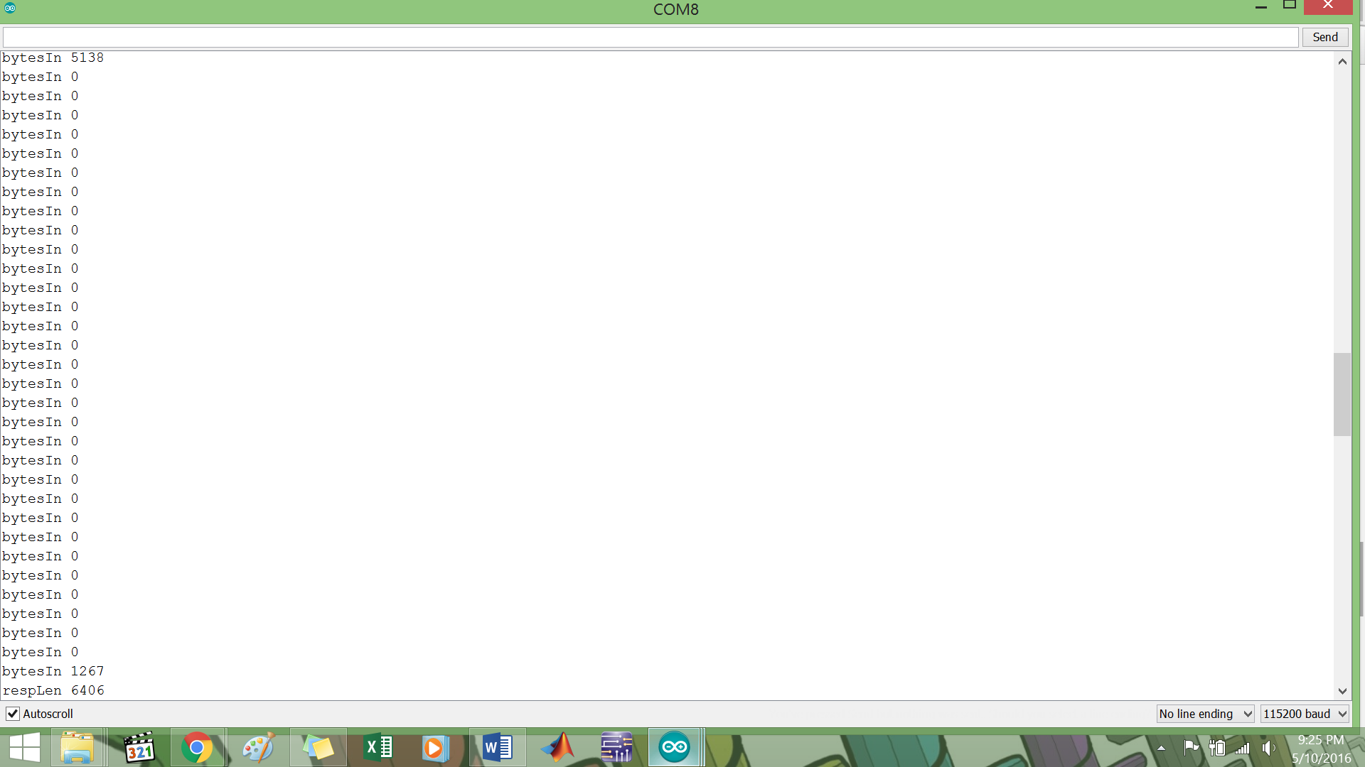

So, I noticed that it was receiving 4096 and then a bunch of 0’s, and i remembered seeing it being declared. I also noticed it’s a power of 2, and having taken some computer classes i was wondering if this was a max or something. but i doubled it to 8192, and it was able to get 5137 then maybe it drops the load and gets the zeros and picks up what is left, totaling 6405. So it seems that the 4096 may have been there to stop from issues, i’ll take a second look to see it there’s another limiter in the program.
I checked and http://api.wunderground.com/api/api code/conditions/q/autoip.json gives me actuate data. im gonna try to parse the latitude longitude from that.
Quite true! static char respBuf[4096];… that should mean 4096 characters buffered (don’t know if that’s the right word or not). Based on the JSON character count (I think I used this) you should be able to scale that number.
Either way… hope this is fruitful!
I haven’t gone back to see if I could change it to get the larger page in (although I need to do so for future projects). But, using conditions instead of geolocation gave me the latitude and longitude just on a smaller page. but i was having issues getting to the data because it was inside "display_location", and after trying everything i could think of a quick google search showed an example of a guy using location = parsed_json['location']['city'], dont think I would have tried that.
But its working now. Thanks again for your help. I’ll be sure to post my project when its finished.

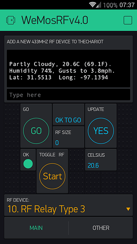

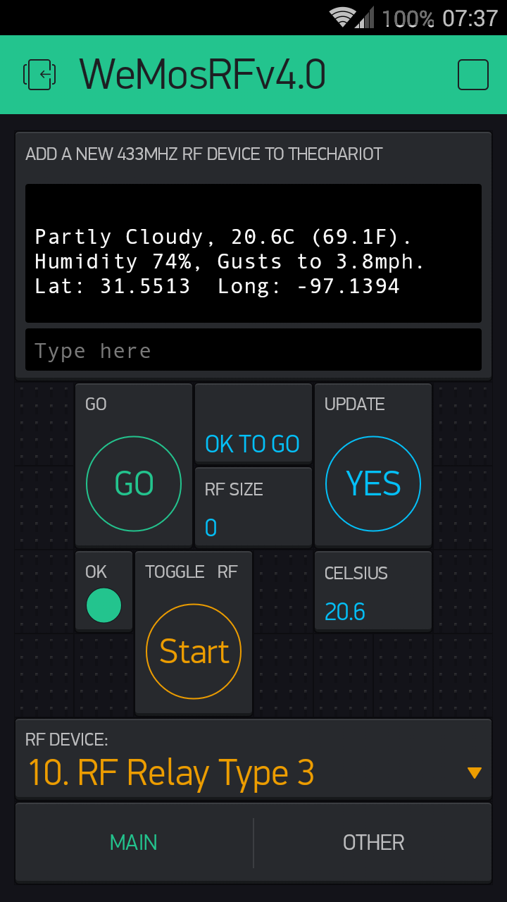

Current weather conditions for Waco, Texas are shown in the Terminal window of the screenshot below.
We can set a location in WiFi Manager and change it with the Terminal, or Menu, widget etc.

@JoeS thanks Joe but as shown in the screenshot I can get all that data already. I am after some data from today’s forecast. From the links I provided, with a valid API key, the forecast WITH conditions json starts with:
