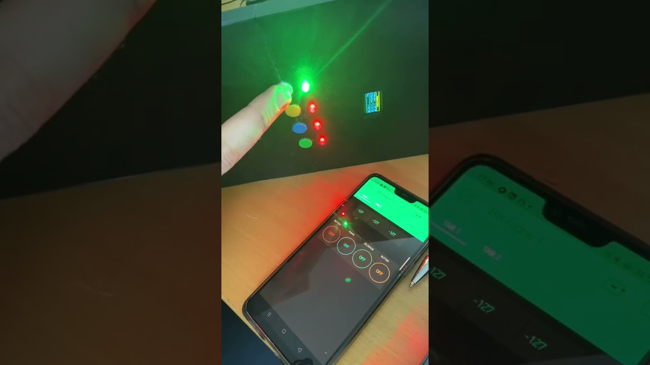

My psychic powers don’t extend to understanding exactly what this means :frowning_face:
I know you don’t like videos but it’s easier for you to understand my problem.
Don’t forget to put on some sound
Try updating the button with the exact state of relais.

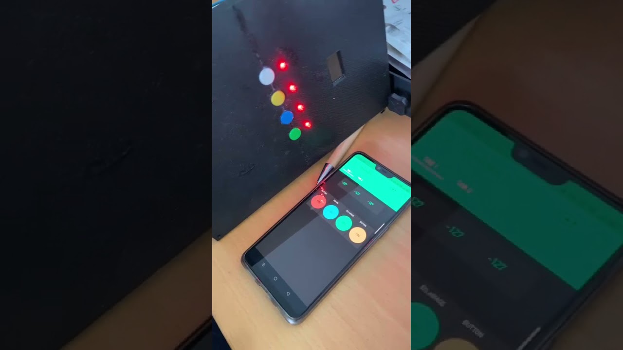

thank you for your help, the synchronization is not yet optimal. I also have conection and deconection problem.
look on my phone.

Hi Pete,
I will try and explain it in words as i am not really fluent in English. So what is happening is that when I switch on the ESP32, the synchronisation takes a couple of second for it to match with the app on my phone. Then on the app, there’s a pop-up saying “one device connected” and following this, a couple secs later, new pop-up appears with message “disconnected”.
Once everything is switch on, the syncronisation between the app and the ESP32 matches regarding “on=green light” and “off=red light”. But when I press the buttons mannually on the ESP32, it looses the syncronisation after two or three clicks, taking note as well that it seems that this glitch is random which means sometimes it stays synchronised and sometime it doesnt and that applies for all the manual buttons on the ESP32.
Now when I start by manually switching on or off the buttons on the EPS32 but then switch to the app, there’s one click delay, find example below the summary of the video i have sent through in words:
On EPS32, all buttons are off with synchronisation on the app. Pop-up appears with “one device connected” then a few secs later another pop-up with “disconnected”. But synchronisation between the app and ESP32 is done and what’s appearing on the app is reflected on the ESP32 so since on the app it’s “on”, all the lights changes from RED to GREEN.
Once you click on one of the button manually on the ESP32 (note that now all the buttons are GREEN as they are ON), the light on the ESP32 turns RED but on the app it doesnt change and still indicates ON. Another click and the light on the ESP32 turn back to GREEN and on the app it shows “OFF”. Now going on the app, I switch the same button to “ON” and the light on the ESP32 turn RED then with a delay of 2 secs, it switches back to GREEN.
From my observation, it seems that the communication between the app and the ESP32 is not reliable and it looses it connection somewhere or somehow thus having those glitches appers when doing the testing.
Hope this helps you understand and thanks for your help.

I then press the physical button, I need two presses to change the state

is it possible to remove this second pressure so that it works the first time ?
Okay, you’ve complicated this enormously by adding that debug code to each physical and widget button instead of following with my advice that…
I think you had your btn1State = LOW; command in the wrong place. I’ve changed it in the code below.
Please just test button 1 and widget button 1 with this code.

Thanks for the code, but the problem is still there.
  1. I turn on my ESP and I press the button widget, the change of state is very good.
  2. I press the physical button for the first time, nothing happens
  3. I press a second time, the change of state is to pass
  4. if I press the physical button again there is a change of state
  5. I press again on the button widget, the change of state is done very well.
  6. I press the physical button again, nothing happens
  7. I press a second time, the change of state is to pass
And your latest code and serial monitor output when performing the actions you’ve outlined?
