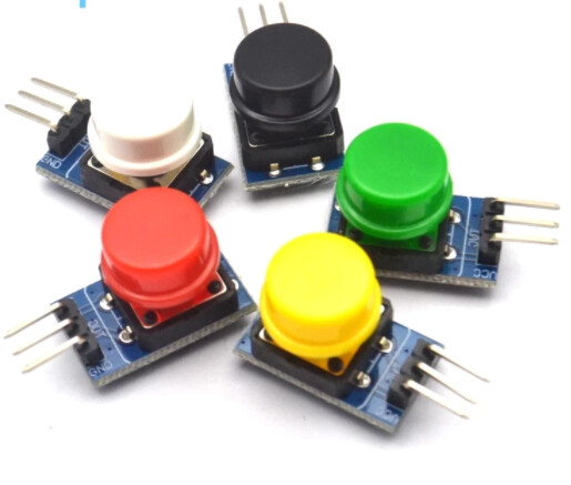

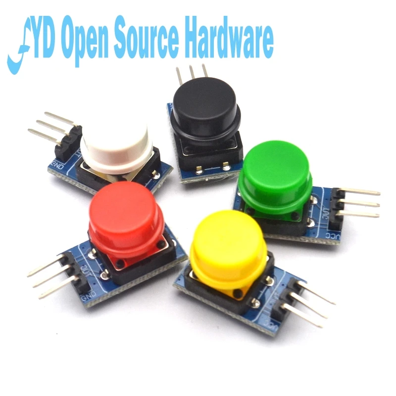

const int relais1 = 14;
const int btn1 = 27;
const int ledV1 = 5;
const int ledR1 = 2;
const int relais2 = 32;
const int btn2 = 26;
const int ledV2 = 18;
const int ledR2 = 4;
const int relais3 = 15;
const int btn3 = 25;
const int ledV3 = 19;
const int ledR3 = 16;
const int relais4 = 12;
const int btn4 = 33;
const int ledV4 = 17;
const int ledR4 = 13;

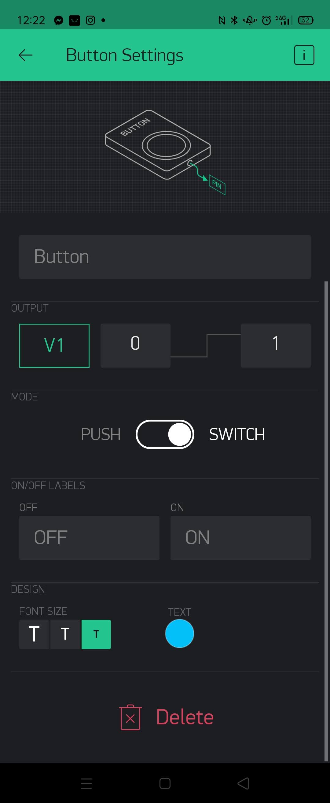

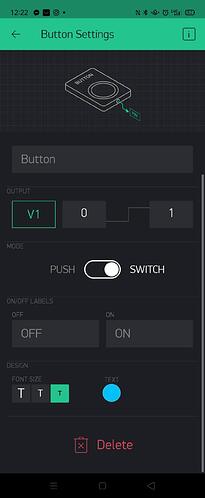

BLYNK_WRITE(V1) {
relais1Sate = param.asInt();
Serial.print("Widget Button V1 changed. Writing ");
Serial.print(relais1Sate);
Serial.print(" to Relay 1 and LED V1, and ");
Serial.print(!relais1Sate);
Serial.println(" to LED R1 ...");
digitalWrite(relais1, relais1Sate);
digitalWrite(ledV1, relais1Sate);
digitalWrite(ledR1, !relais1Sate);

WiFi.begin(ssid, pass);
//timer.setInterval(3000L, checkBlynk); // check if connected to Blynk server every 3 seconds
Blynk.config(auth);
sensors.begin(); // debut de la librairie capteur de température
pinMode(relais1, OUTPUT);
pinMode(btn1, INPUT_PULLUP);
pinMode(ledV1, OUTPUT);
pinMode(ledR1, OUTPUT);
pinMode(relais2, OUTPUT);
pinMode(btn2, INPUT_PULLUP);
digitalWrite(relais2, relais2Sate);
pinMode(ledV2, OUTPUT);
pinMode(ledR2, OUTPUT);
pinMode(relais3, OUTPUT);
pinMode(btn3, INPUT_PULLUP);
digitalWrite(relais3, relais3Sate);
pinMode(ledV3, OUTPUT);
pinMode(ledR3, OUTPUT);
pinMode(relais4, OUTPUT);
pinMode(btn4, INPUT_PULLUP);
digitalWrite(relais4, relais4Sate);
pinMode(ledV4, OUTPUT);
pinMode(ledR4, OUTPUT);
if (!display.begin(SSD1306_SWITCHCAPVCC, 0x3C)) { // Address 0x3D for 128x64
Serial.println(F("SSD1306 allocation failed"));
for (;;); // Don't proceed, loop forever
// Clear the buffer
display.clearDisplay();
display.display();
timer.setInterval(100L, checkPhysicalButton1);
timer.setInterval(10000L, temperature);
// You can inject your own code or combine it with other sketches.
// Check other examples on how to communicate with Blynk. Remember
// to avoid delay() function!
My serial monitor
16:35:38.421 -> [5243] Connecting to blynk-cloud.com:80
16:35:38.797 -> Location A, btn1 = 0 btn1State = 0
16:35:38.865 -> Location A, btn1 = 0 btn1State = 0
16:35:38.966 -> Location A, btn1 = 0 btn1State = 0
16:35:39.068 -> Location A, btn1 = 0 btn1State = 0
16:35:39.103 -> [5974] Ready (ping: 311ms).
16:35:39.448 -> Location A, btn1 = 0 btn1State = 0
16:35:39.482 -> Location A, btn1 = 0 btn1State = 0
16:35:39.585 -> Location A, btn1 = 0 btn1State = 0
16:35:39.686 -> Location A, btn1 = 0 btn1State = 0
16:35:39.721 -> Widget Button V1 changed. Writing 1 to Relay 1 and LED V1, and 0 to LED R1 ...
