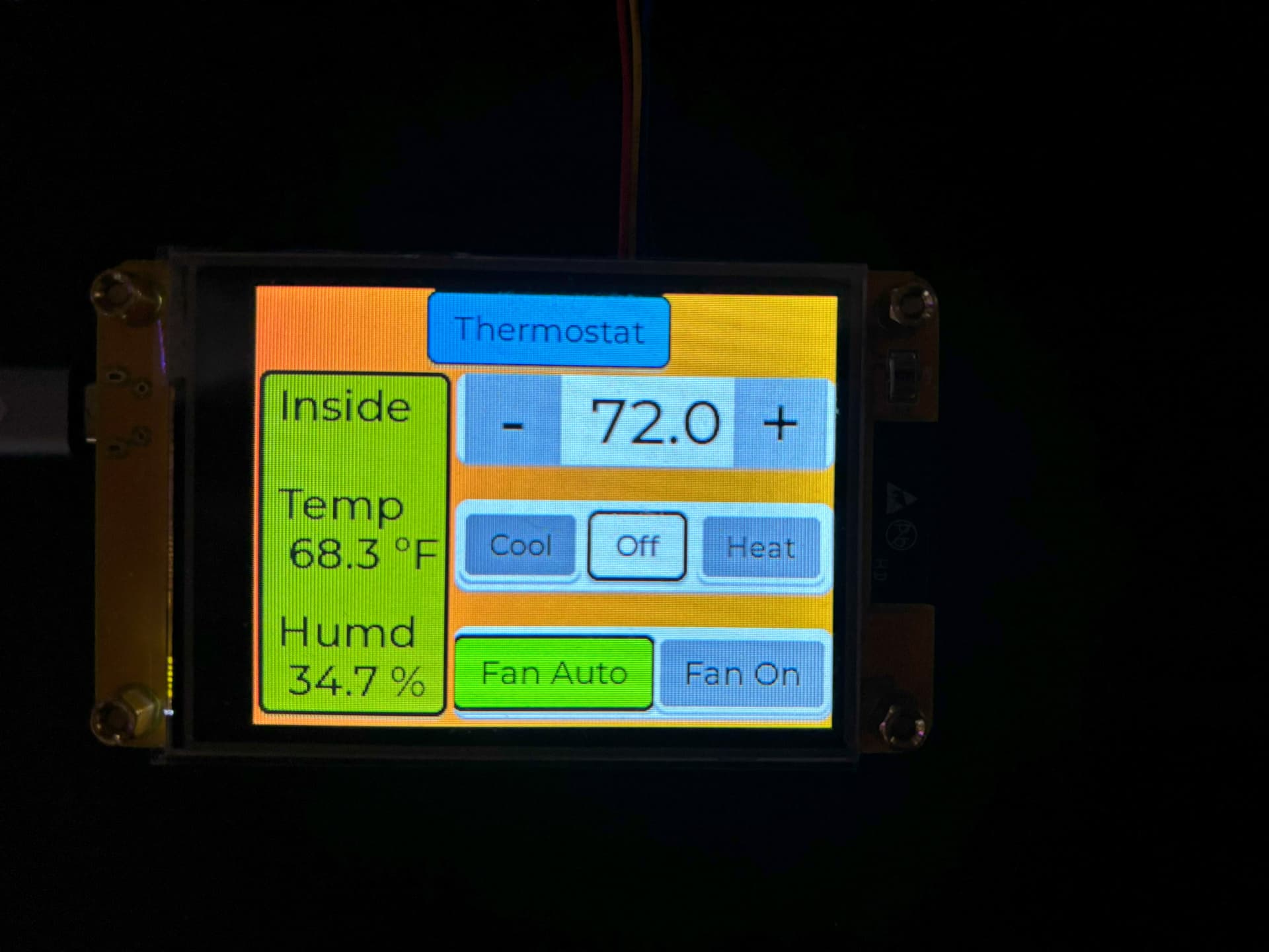

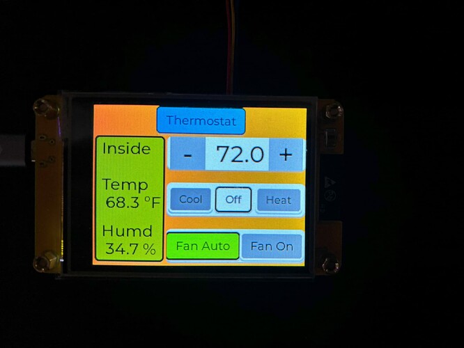

Using a cheap yellow display (CYD) to interface to an existing template like a phone
So my wife and I have been using a Blynk App for years to control a thermostat I developed with an ESP8266. The ESP8266 has the logic and Blynk code to control the relays that interface with the auxiliary equipment. Everything works great!
So now I developed a ESP32 Cheap Yellow Display (CYD) interface that looks just like the display on our phones. I would like to use this CYD much like a phone to interface with the Blynk IOT template to control the thermostat. Is there a way to do this?
