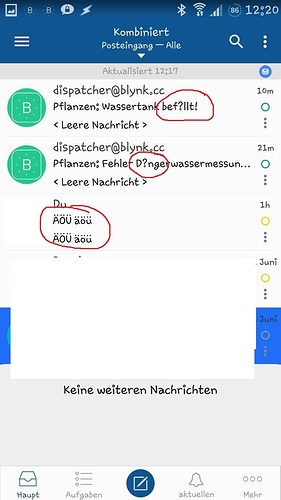

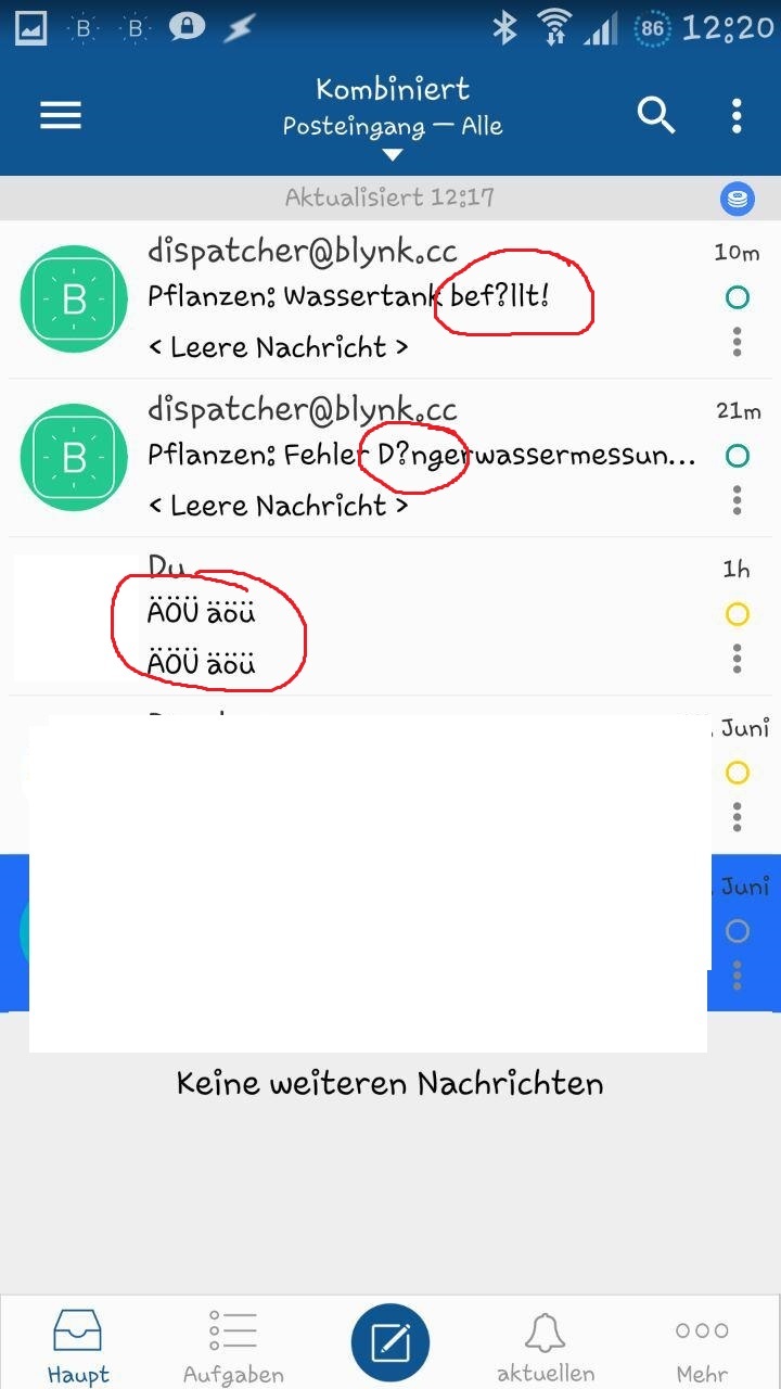

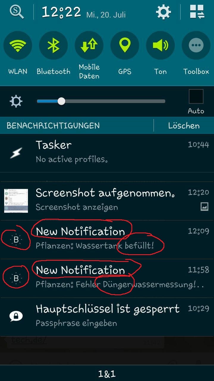

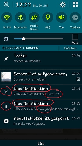

While german umlauts will be shown correctly in notification they won’t show correctly in Blynk Mail.

But for me Notification is working correctly but Email isn’t shown with umlauts.

Subject: =?ANSI_X3.4-1968?Q?Pflanzen:Fehler_D=3Fngerwassermessung!?=
=?ANSI_X3.4-1968?Q?Dringend_handeln!_-_Pumpen_deaktiviert!?=

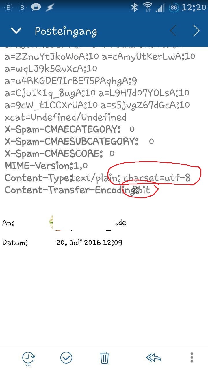

Content-Type: text/plain; charset=“UTF-8”
Content-Transfer-Encoding: 8bit

It has the normal encoding when I look at the Header on my mobile phone.
But that’s not working there either
Not the client specifies the encoding. The server sends this within the mail-header.
Charset UTF-8 / 8 Bit on my mobile phone but “ü” is displayed as “?”
