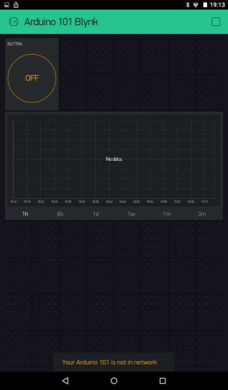

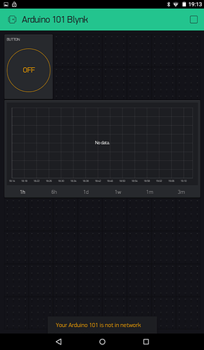

I’m trying to use Blynk with Arduino 101 and BLE. I know BLE is still in beta.
I’ve added the authentification token to the Arduino_101_BLE sketch and uploaded it.

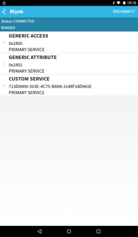

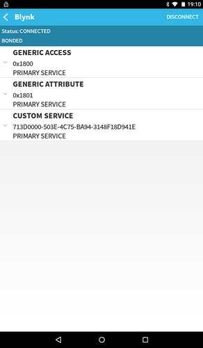

On my Iconia One B1-770, BLE Scanner does find Blynk and its services…
…but Blynk fails to connect.
Am I doing something wrong? Is there a debug trace I can send you?

Where is your BLE widget?
