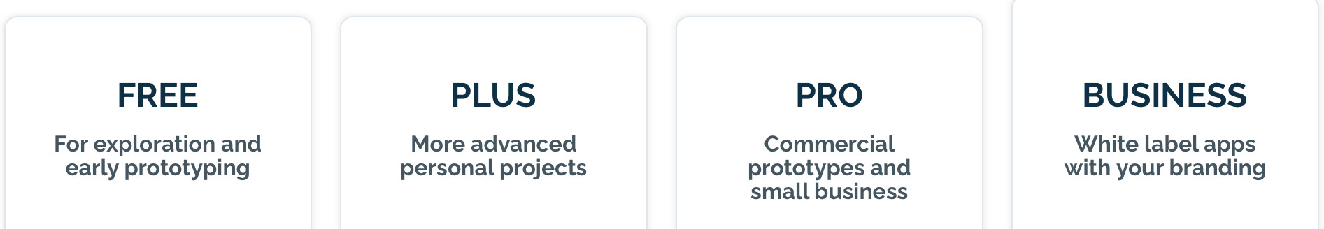

I think you have to bear in mind the advertised purpose of each of the subscription types…
If you are using the Plus plan for personal projects then restricting users (effectively family members) to certain devices is probably outside of the scope of that type of subscription.
There is an issue with the fact that Plus plan subscribers can edit the permissions for the ‘user’ profile, and the default permissions are useless, but that’s a separate issue that I’ve raised a number of times.

It’s basically a plan for “makers” who want to build their own home automation systems and and share that system with other members of their family/household.
One of the things that the guys at Blynk learned with the legacy product is that it’s very difficult to identify the people who are using the Blynk product commercially without a commercial subscription.
That has clearly been addressed in the new product, with different subscription levels required to unlock different features, and the Pro plan is the subscription needed to achieve that type of functionality.
The Basic (free) plan is the “come in and take a look around” subscription, with Plus filling the gab between that and the commercial level of functionality.
