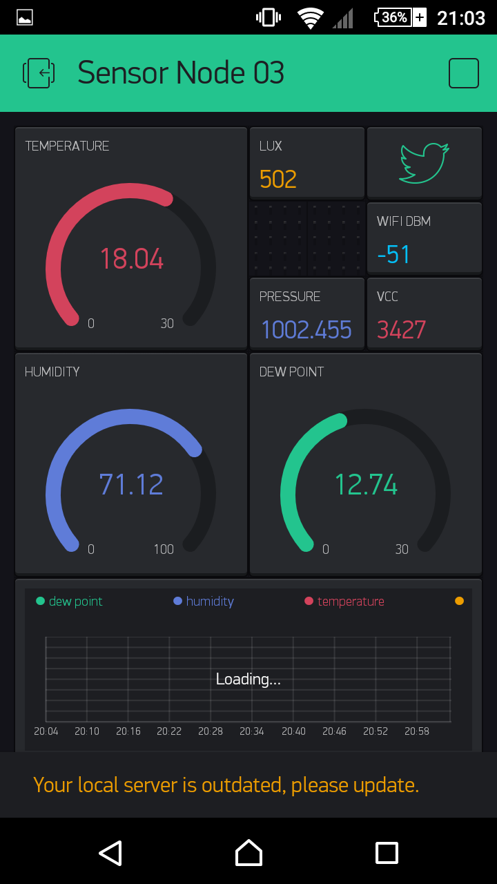

OK, so i have created a new Blynk login, and sent a project via “clone app” from my Blynk cloud account.
but the app says: “your local server is outdated, please update”
i put 16.2 on there - this is the latest?

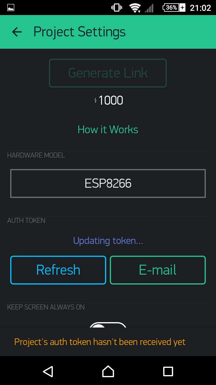

also when i try to email the token, it says: “Project’s auth token has not been received yet”
so how can i add the auth to my hardware???
also - when i close the Blynk app, it loses the cloned project??
i created a new project, and it sticks, but the cloned project disappears?
is my local server not working?
Where do you see this message?
in Project Settings when i click on E-mail token button

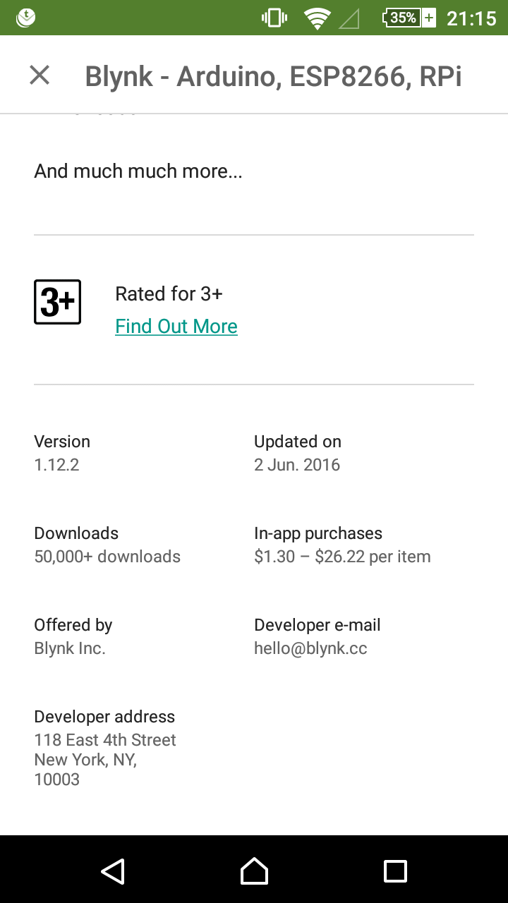

app also says “your local server is outdated, please update”
What app version do you have? look like it is outdated
