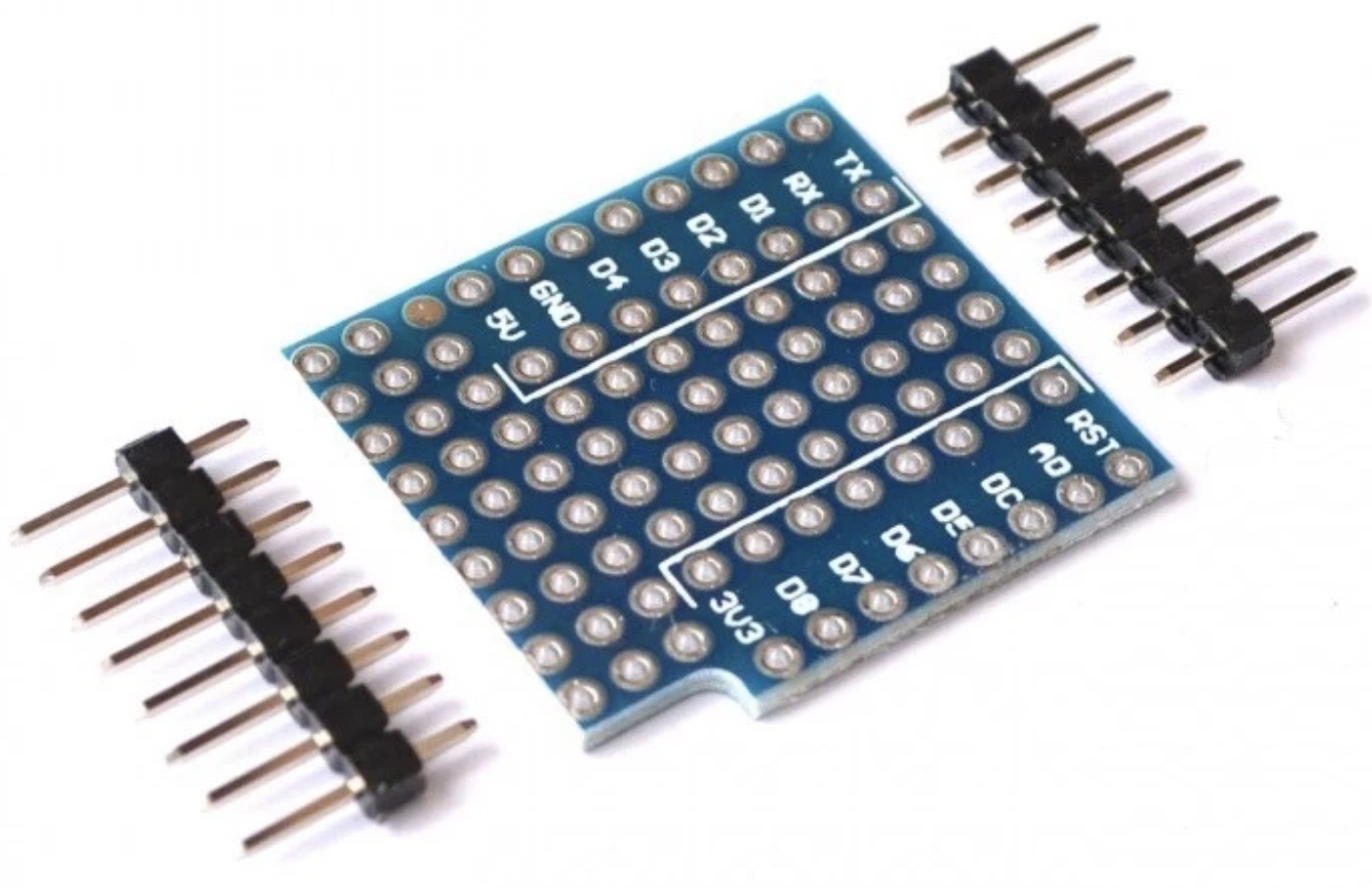

What setup would you use for prototyping vs a breadboard?
You could use one of the Wemos proto boards, as discussed in this topic…
Pete -
Thanks for this—literally the first article I found that got me interested in using Blynk. I am using a Wemos D1 Mini for my prototyping and am using a breadboard to interface with the relay circuitry, so I was confused when you said that breadboards are a bad idea.
I suspect from your comment that you didn’t understand the difference between a D1 Mini Proto board and a breadboard.
This type of proto board requires the joints to be soldered…
which is better than using a breadboard. All breadboards can produce high resistance connections, and the cheap ones are usually far worse than most. They are also prone to wires being disturbed very easily when the position of the components moves around on the bench.
If you’re only using a couple of relays then you could of course go for a Wemos triple base and two Wemos relay modules.
