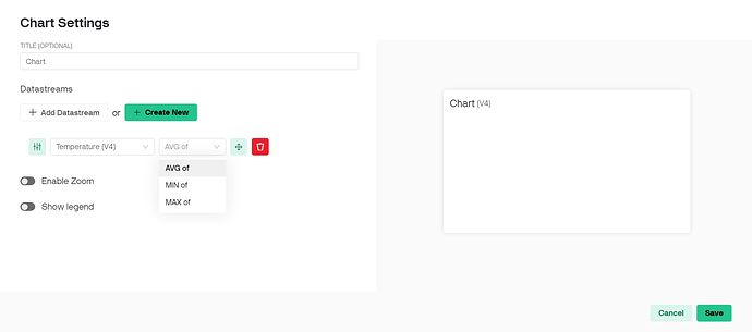

I’m missing the RAW option in the WEB Chart settings. I.e. I can’t configure a chart for anything else than AVG, MIN and MAX. But not RAW (or others).
Problem:
  • My charts, or graphs rather, in WEB dashboard looks like they don’t display the latest value (if data is changing much) as they show an average and not the actual (raw?) data.
I really would prefer the RAW method as that will show the latest more precise. And you can sooner and better see trend changes.
Anyway, the RAW is not possible to select in chart settings. See images.
  • Is this a bug or is RAW only valid for other plans, other chart types or maybe for other data types?
Help text says RAW should be there:
In reality, no RAW in settings:
Note, the screenshots is for a VBAT plot. For this parameter this is not important as VBAT has slow changes. But I have others with faster changes …
To get the Raw Data option you need to have “save raw data” turned on in the datastream’s Advanced settings, then the option is available…
However, I don’t think that raw data storage is available with the free subscription.

  2. As Pete pointed out it is an option under Advanced settings to enable RAW data. And it has a button “UPGRADE” which clearly tells me I have to upgrade to get this feature. OK.

I recently purchased a the Pro subscription. however my chart does not allow me to Save Raw data
Any clue as to why?
Have you enabled raw data in the datastream advanced settings?
Hi Pete,
My apologize, I did not see the enable function in the advanced settings.
