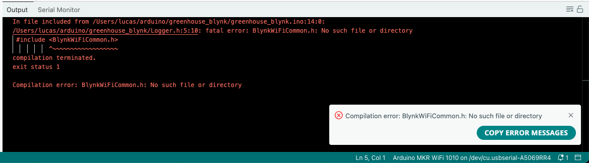

What is the recommendation for including Blynk in header files or other cpp files? I tried this in a header file and I get the following error.
#ifndef LOGGER_H
#define LOGGER_H
#include <Arduino.h>
#include <BlynkWiFiCommon.h>
class Logger
public:
Logger(Stream *stream, BlynkWifiCommon *blynk);
#endif // LOGGER_H
I get Compilation error: BlynkWiFiCommon.h: No such file or directory

Or, I could point you to a topic that asks you to provide the required information. I did the latter, and you responded by adding a few extra words and a screenshot, which tells me nothing that I need to know.

I’m asking a straight forward question about the library in my post. The topics in that post aren’t even relevant to my issue.
full model of your hardware, like ESP32 Devkit V1 ;
Provided
attach logs in serial monitor of IDE, like:
My sketch won’t compile. There is no serial data to monitor
provide your full sketch (remove AuthToken, WiFi credentials, etc.)
provided
also provide a screenshot of the error in the output if there is an error
provided
Specify your server,
Irrelevant
If you have a problem with the mobile app
I don’t
If you have a problem with the web console, please provide:
I don’t
Also, if possible, please attach
Screenshot provided
If you have a bug, please provide steps to reproduce it if possible.
Not a bug
Also please write your plan, like FREE, MAKER 10,20, PRO 40,100,500,1000
Free
I’m happy to provide any other information. Not trying to be difficult.

it is
#include <Adapters/BlynkWiFiCommon.h>
