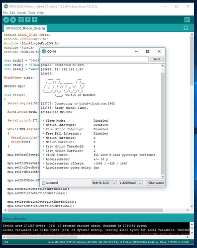

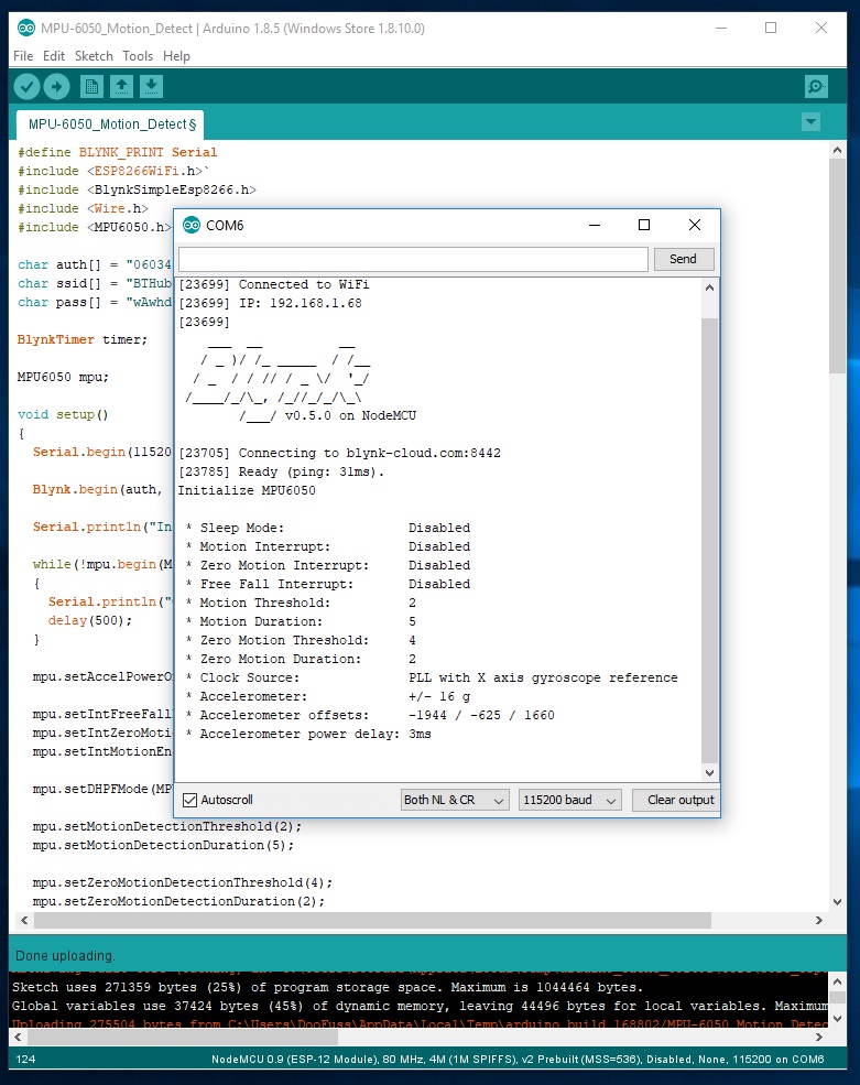

@Toro_Blanco Google is king.
While waiting for it to compile and upload I found this.
mpu.setMotionDetectionThreshold
