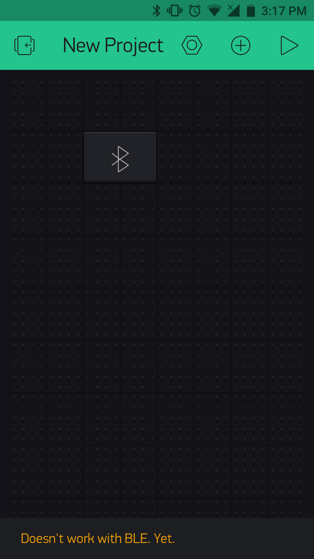

PS: i read somewhere that BLYNK app is giving some issues with the BT module, should i get an esp module or a NODE MCU esp and integrate my project on that? will it be any more complicated that this one ? iam planning to get either one of them in next 90 mins or so , i did not sleep the whole night and NOW IAM ADAMANT TO SEE IT WORK AGAIN B4 I CAN SLEEP PEACEFULLY.
