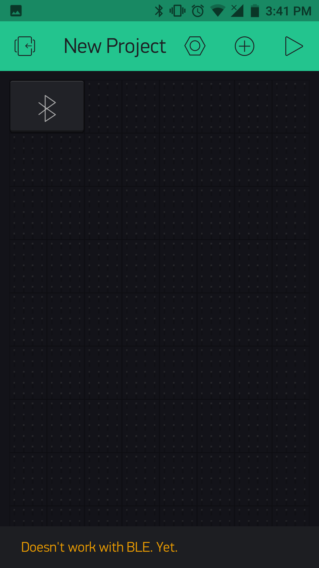

I am adding the Bluetooth widget(Not BLE) in the blynk app on Android but after adding the widget it does not allow me to add any other widget and says doesn’t work with BLE yet but I am using the normal Bluetooth widget.
I am using Android 8.0
Please find the images attached below.
This is not an error… BT/BLE is a direct link between the App and device, thus no internet/server link on the device as it would have with WiFi. Thus certain widgets that require device to Server link will not work with BT/BLE.
I am unable to add even a button widget
Show that screenshot
The first screenshot is taken after selecting the button widget

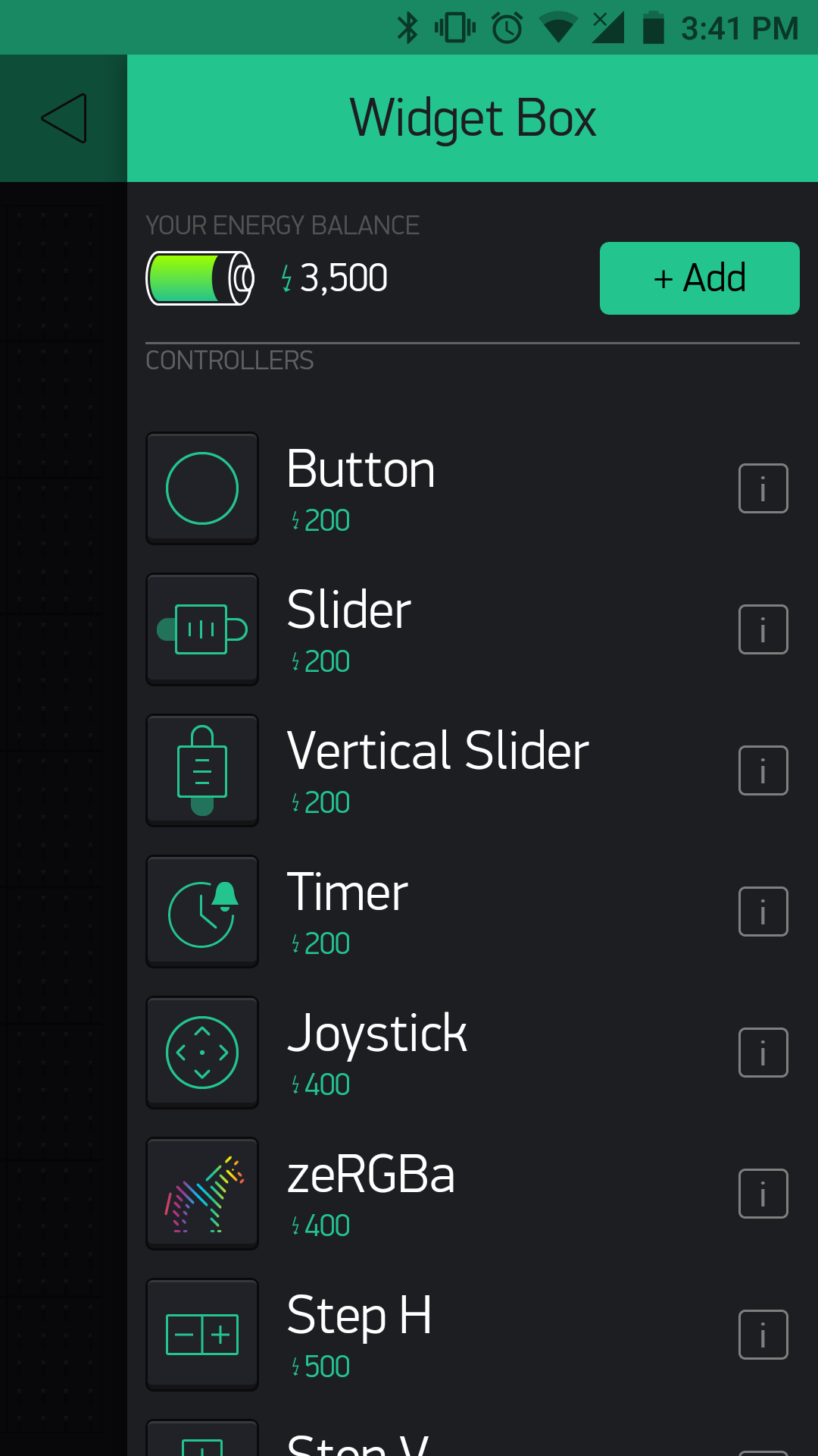

Show the Widget Box with the buttons and displays and this supposed error… so far all you have shown is the widgets that require aforementioned Device-Server link
This is the widget box.
Now, I press the button widget, nothing is added and I get this message-
I am using Android 8.0 on Mi A1
I am able to add buttons if I remove the Bluetooth widget
OK, hold yer horses :stuck_out_tongue: I was able to confirm this issue… even on Android 4.4.2
Heads up @BlynkAndroidDev Issue is: Unable to add any widgets if BT widget is already in place, it must be removed first, then added last.
