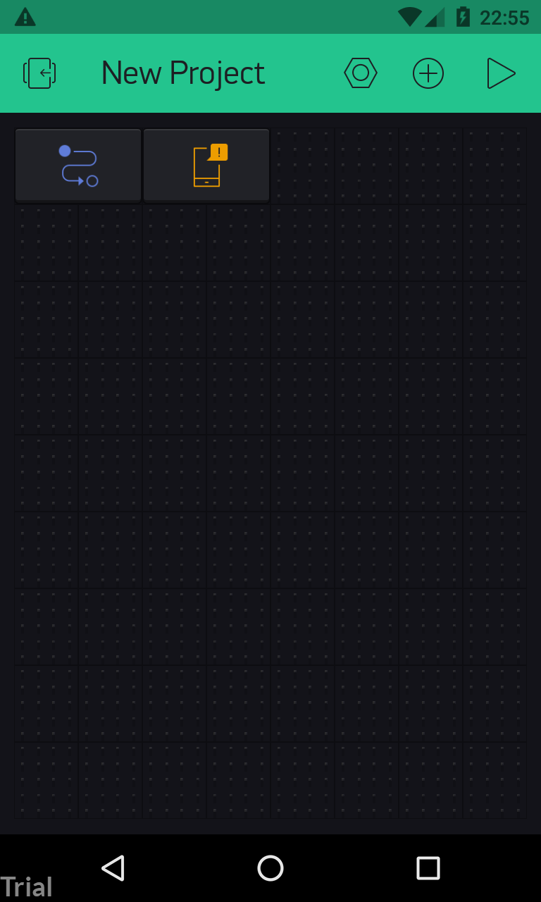

  1. Change time zone in Android to something else than your local time zone (I took Vladivostok) and use 24h format.
  2. Add Eventor and Notification to Project
  3. Add new event in Eventor and select Time
  4. Look at your PC time, hand watch, your grandmothers watch (one that works ofc.) and add +10 min in front. Set the time zone in eventor to your PC time zone, I am located in Austria so I took Vienna. Keep all days of week selected. Press “Set the time”
  5. Add Notification as triggering event
I expect the msg “It is Working!” to appear in the next 10 minutes, this is not the case because the time zone in Android is wrong, this means Eventor takes time zone from Android (image 1) as the input and not the time zone from Eventor (image 4).
