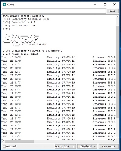

Strange that the app is bad and no problems showing in Serial Monitor like reconnects etc.

I am running your sketch with the super WeMos D1 Mini and a BME280 and it’s fine.
No disconnects here.

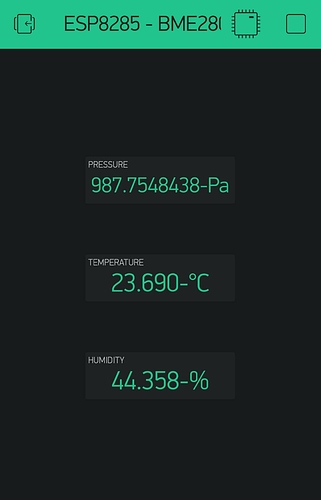

I think its the app on my phone?
I created a simple sketch with 6 vitual pins, loaded it onto the 8285 and altered the app on me phone to view all 6 pins.
The first three go on and off, the last three are as they should be, permanently on.
Here, see for your selves.

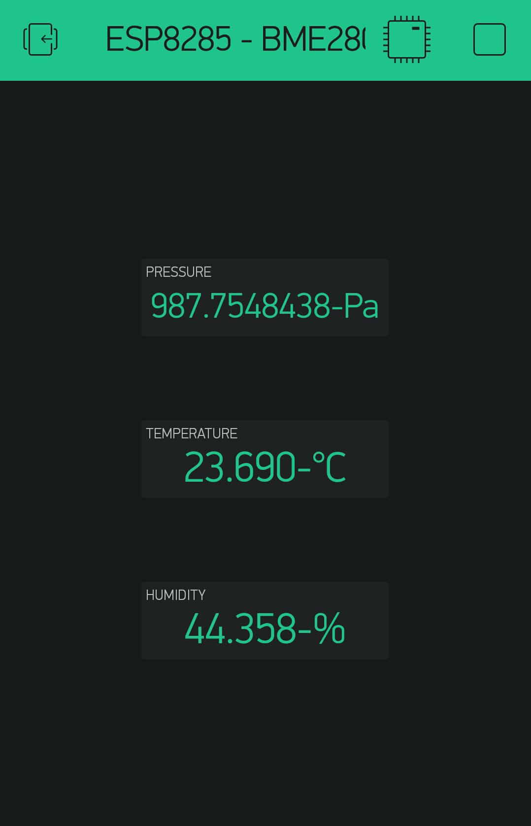

@Costas It was the Blynk app on my phone.
Your sketch works perfectly, the problem was with theBlynk Project in the app on my phone. I’ve completely deleted the project and quickly made another, your sketch works perfectly, so does this little 8285.

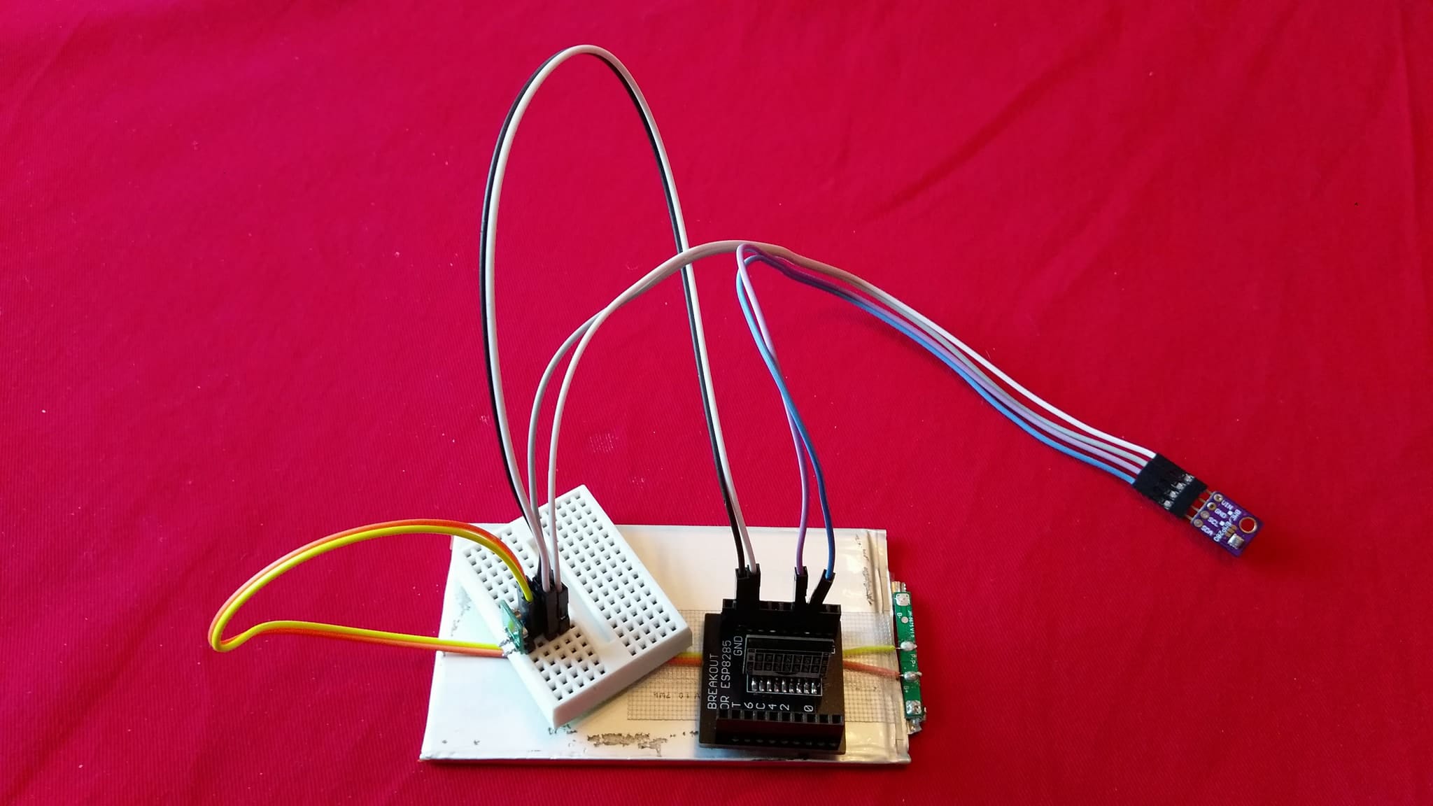

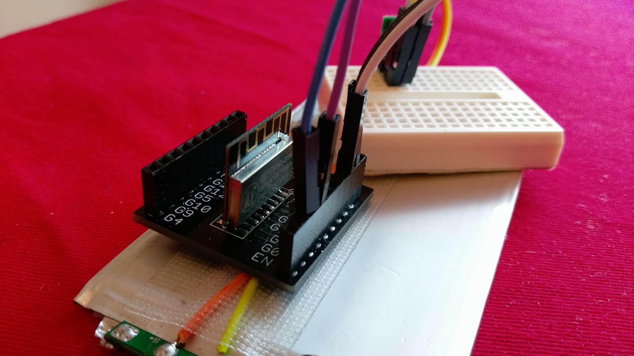

Hi guys, thanks for all your help, we got there in the end.
Its now working as it should. Not really sure what caused the issues in the Blynk app, was probably something i did.
Anyway here’s a couple of pics of the little beasty and the the now stable reading on my phone.
