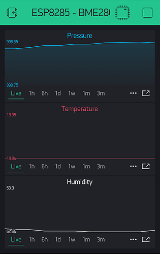

Your next mission (should you choose to accept it) is to research how to round numbers to one decimal place.
Personally, I prefer my atmospheric pressure to be a whole number with no decimal places, temperature to one decimal place is a useable figure, and humidity with no decimal places works well for me, but one decimal place would also work.
I think the “-“ symbol between the number and the unit of measurement is a bit confusing, it looks like a minus sign to me.
You can also add a Superchart widget to display all three pieces of data on one graph, which makes more sense of the data. Atmospheric pressure in particular needs a chart to show the data so you can see the trends and help predict what’s happening with the weather (okay, you’re in the UK so we know it’s probably going to rain sometime soon).

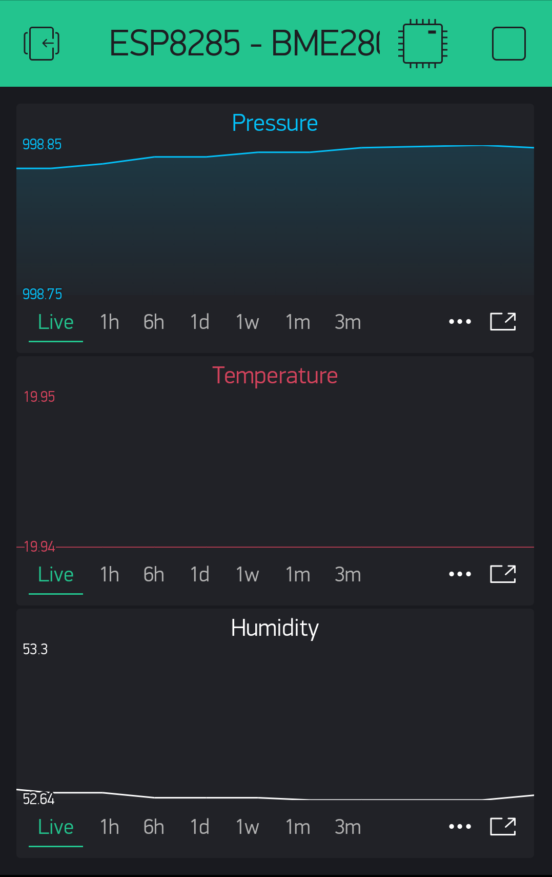

Now that I have some data to play with, which seems to have stabilised over night, maybe the BME280 requires a “burn in” period? I’ve had chance to play with the Blynk app, its so cleverly designed, what a brilliant idea.
Yes, I accept the mission, i’d like everything to 1 decimal place. I’ll report back soon. :wink:
In the meantime, check this out.
I left it running in the utility over night while it’s LiPo battery charged up, gave me time to play with the graphs etc in the app. No more weird minus sign. :wink:

You don’t need three separate chart widgets, one chart connected to thee different data streams is the way to go.
No ‘burn-in’ period that I’m aware of, but they are very sensitive to being in proximity to people (and dogs) as the heat and moisture from your breath and body will affect the sensors.

@PeteKnight 3 separate charts do have some advantages, Blynk gets enormously wealthy and user has better looking charts i.e. not the gruesome 3 axis labels pushed to the left and the reduced real estate.
So more $$$ and dancing girls for us maybe?:crazy_face:
I actually have one of these sensors feeding a single superchart and it’s really useful to see the relationship between temperature and humidity, and to a lesser extent pressure. It’s offlinr at the moment, otherwise I’d post a screenshot.
@PeteKnight I did try the 3 into 1 chart but as @Costas says, things looked a little cramped so I went with 3. Hope you enjoy the dancing girls. :wink:
