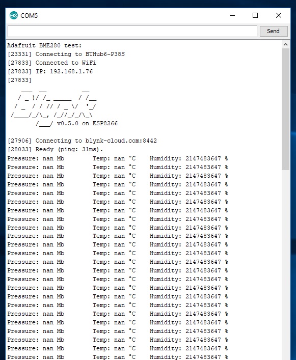

Where it says “nan” instead of a pressure or temperature value it means “not a number”.
I guess that means that you still have problems communicating with the sensor.
Have you tried running one of the BME sensor code examples that get installed along with the library?
In the Arduino IDE it’s Files/Examples/Adafruit BME280 Library…
You’ll have to edit the article sample to use the correct Wire pins and I2C address.

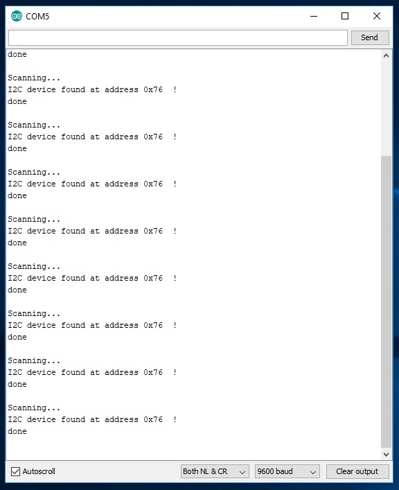

@PeteKnight

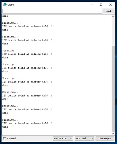

Ran i2c Scanner on the specific pins(e.g. Wire.begin(2, 15); ) and found the sensor everytime.
So I think I’ve found out how to chose the pins I want but maybe I’m using a “special” pin like @Costas said in an earlier post, and thats the problem?

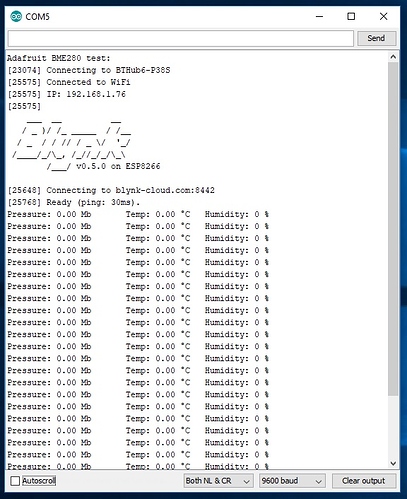

The sensor can’t start until i2c is available. Switch these 2 lines around.
Thanks that has stopped it crashing. :smiley:
I am still puzzled by the pinout issue… if you are using Wire.begin(2, 15); then that has corresponding numbers for both Arduino and board IO for SDA on Pin 2… but completely wrong for SCL to be on Pin 15??
And yet the address detection worked on those pins… but no data…
So, perhaps the address detection doesn’t require full bus/wire connection…
Try Wire.begin(2, 14);
No joy.

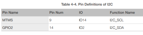

The pin settings for the 01M are very confusing and the pinout @Shadeyman provided is only part of schedule.
See http://wiki.ai-thinker.com/_media/esp8266/esp8266_series_modules_user_manual_v1.1.pdf see top of page 6 of the manual (not page 6 of the pdf) for the rest of the pinout.
I2C_SDA is shown as physical pin 7 (with I2C_SCL being physical pin 15).
Do you have SDA and SCL of the sensor connected to physical pins 7 and 15?
So I would say the GPIO’s are 2 and 14 so Wire.begin(2, 14); should be correct.

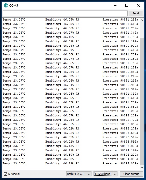

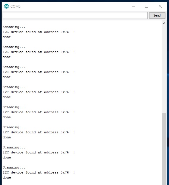

This pin thing was annoying me, so I used i2cScanner and eventually found the sensor using Wire.begin(2, 15); .

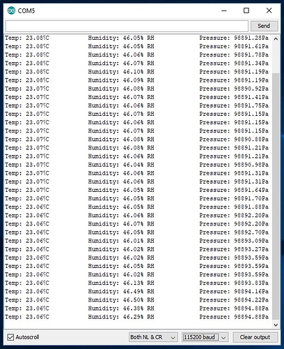

I then used BME280 i2c Test and again found it using Wire.begin(2, 15); .
So obviously I tried the sketch with the same setting, Wire.begin(2, 15); . :frowning_face:
It was only when I took these snap shots that I realised something. My sketch is using an Adafruit_BME280 bme library, and the test sketches were using BME280I2C bme library. now I’m no expert but is the library causing my problem?
