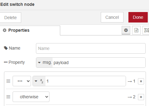

I wanted to try to create a Blynk mobile dashboard to show similar information. I can’t figure out how to change the color of the LED widget on the Blynk dashboard. I found the below post but am unable to replicate those results. I am using Blynk-IOT in node-red. I am not sure what type the data stream should be and am wondering if that is the problem. The data stream the LED widgets are connected to is set to integer. If I create a data stream of type string, I can’t connect the LED Widget to it in the Blynk app. This is the node red flow I have
the switch node:
