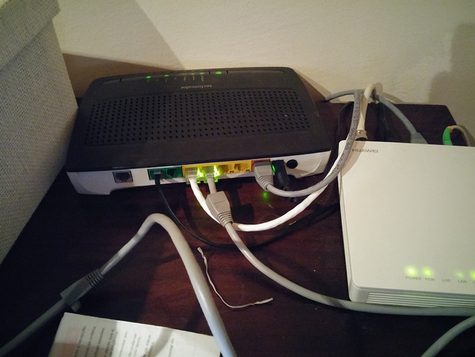

yeah restarted and reseted… maybe i should abandone the ethernet shield and go for a wifi shiel or would i have the same problem?
but its strange cause i have the official ethernet shield rev2, i can connect form my laptop to the cloud and never had a problem connecting devices to my network, never used ethernet tough except for my tv recorder that my provider set up for me but it works great…

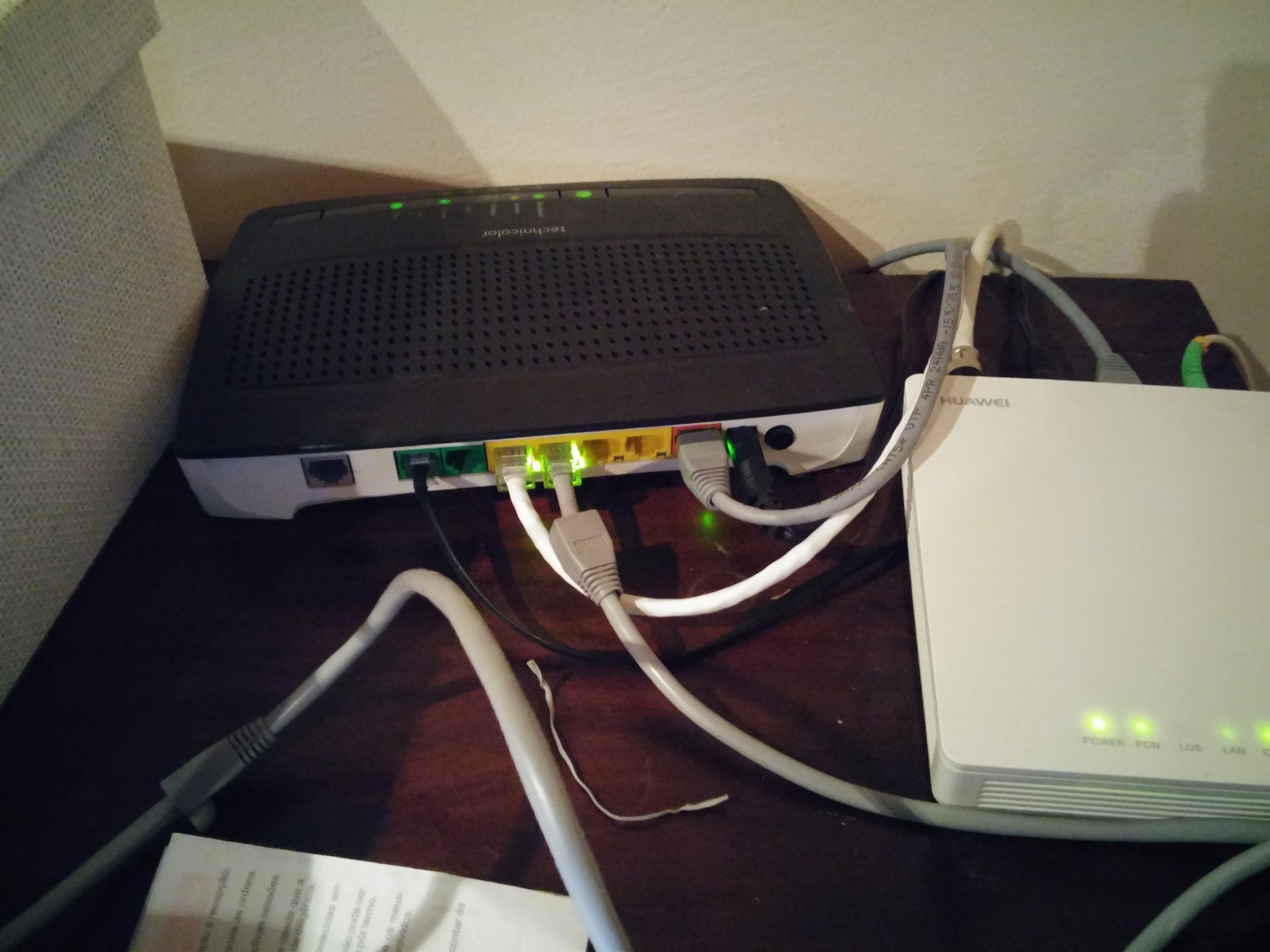

This is my physical connection, the grey one without the protection is connected to arduino
