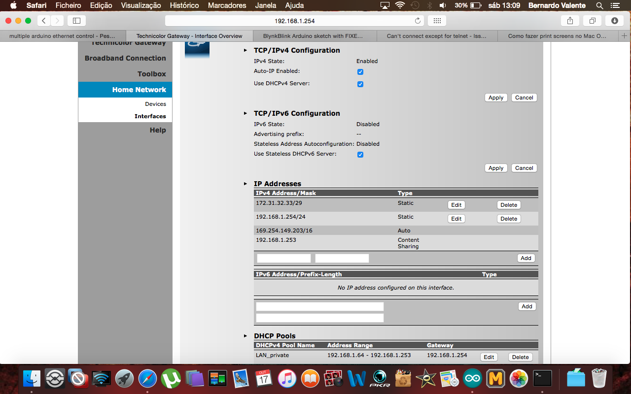

i was trying to use a static ip but i don’t seem to connect to the server

Your IP settings in the Arduino look a bit messed up. It start with 0 and you used 192.x.x.x in your sketch. Have you tried re-uploading the sketch? It most likely is the cause of your problem.
yeah i don’t get it either! i have been trying different stuff for days and i’m not going nowhere…i don’t know what to do more
