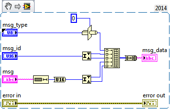

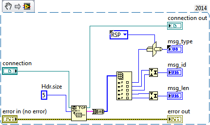

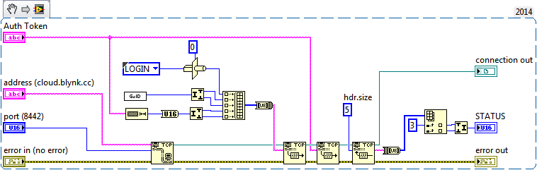

I upload some code (of course in LabVIEW) here to see if some of you are interested in.

Great work, but I only managed to write a value to a virtual pin and send it to the Blynk app on my android device using Blynk Virtual Write.vi
I tried to write a value to a led using Blynk LED.vi but it didn’t work. I don’t know why.
