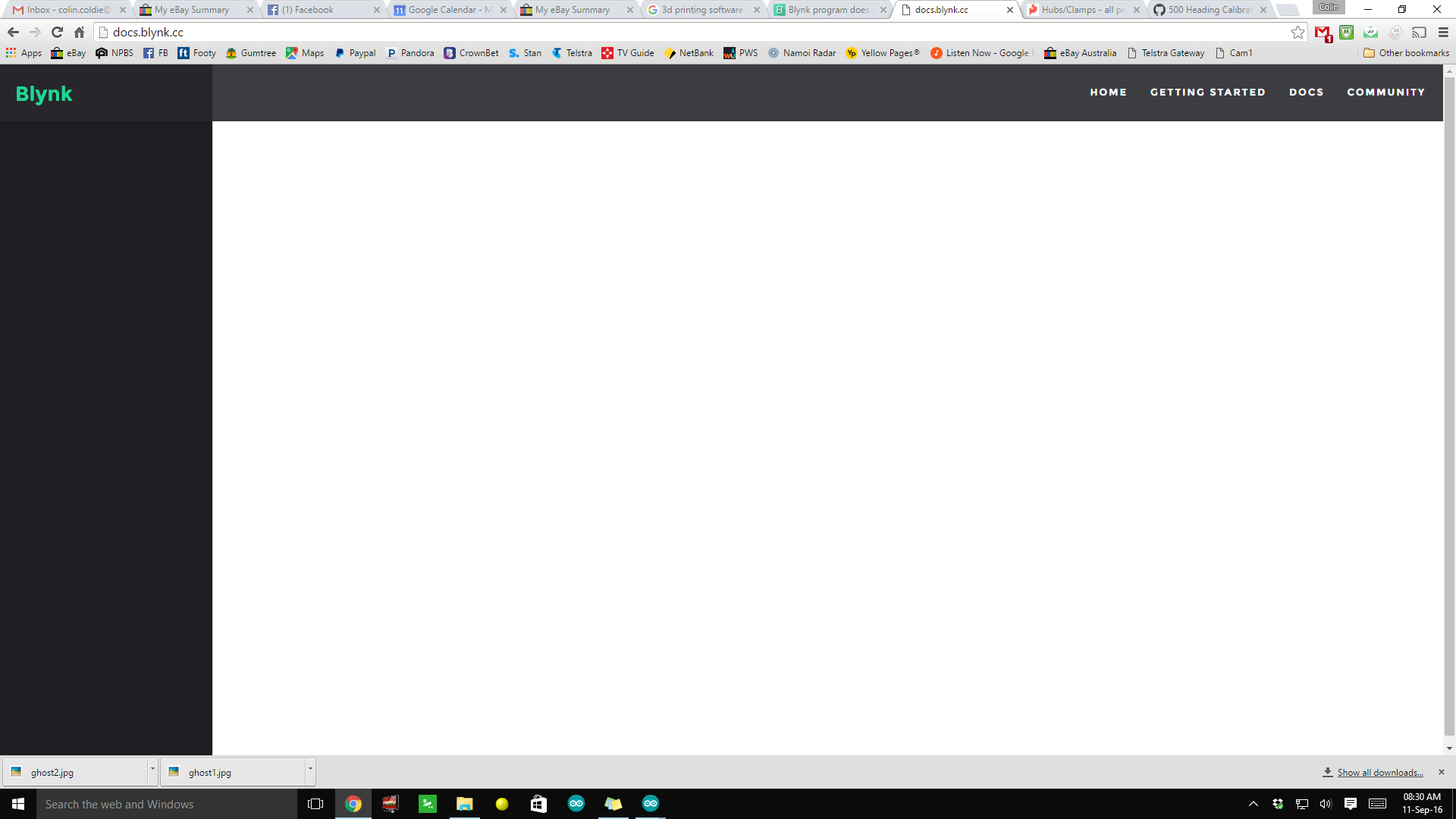

Trying to open your link or anything in the docs section results in a blank white screen. I’ve never been able to open the docs section of your website successfully, yet the other tabs open ok. Where can I find this log file?
@Colin_Cochrane is your Government blocking you from seeing Blynk web pages?
Difficult to use Blynk without access to their comprehensive documentation.
I would fix the web access before trying to fix Blynk access.
Usually in same folder where jar file is. blynk.log
The Home, Getting Started and Community pages load ok, but the docs is just blank. Why would my government block just the Docs page?
The docs are the most important.
Are you running a ZX Spectrum or similar?
Google Chrome, and I just searched my entire hard-drive for “blynk.log” with no file found.

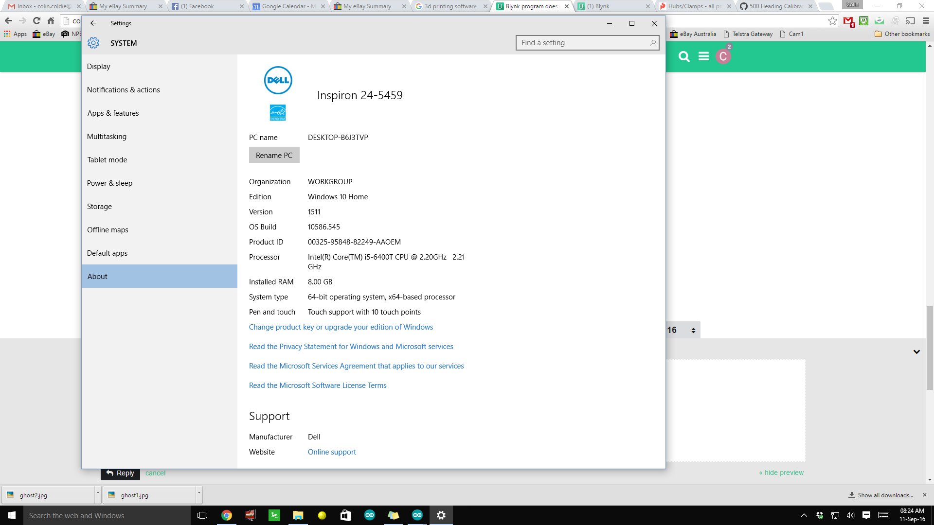

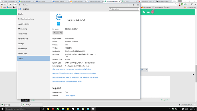

Ok I use

And this the screen shot of the blank page:

So a Dell with Windows 10.

I’m assuming you have regular broadband but a major problem somewhere if you can’t read the essential docs in a web browser. Try some other browsers to see if that helps.
