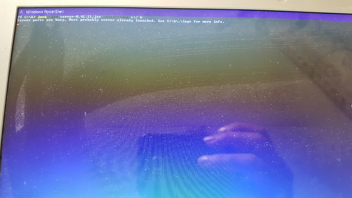

Server ports are busy , edit server properties.
Maybe port 80 is busy or server is already running.
Kill all java instances with windows task manager
How to?
Please help me😔
Do a NETSTAT at MS-DOS prompt to see open ports

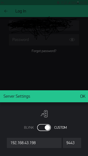

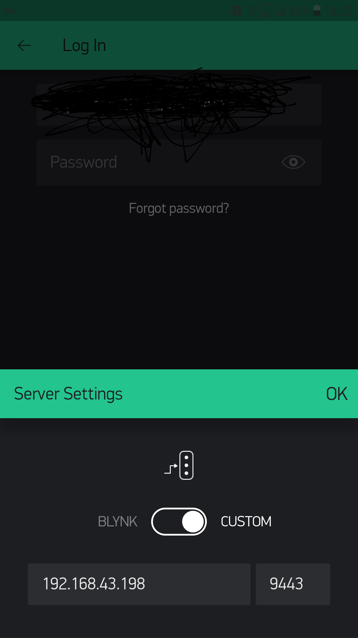

Thanks for your guids…i created a local server by successfuly… after create server i connect my computer to my phone hotspot and upload codes to nodemcu board and also connect it to my hotspot …i would control a led …but my codes not work
What Custom Server settings did you use when you logged in to the app on your phone?
And is that the IP address of your new Blynk server?
Can you ping it from your phone?
Is the Blynk server software running?
Connection is done but when I press the button to turn on the LED. The LED does not turn on
