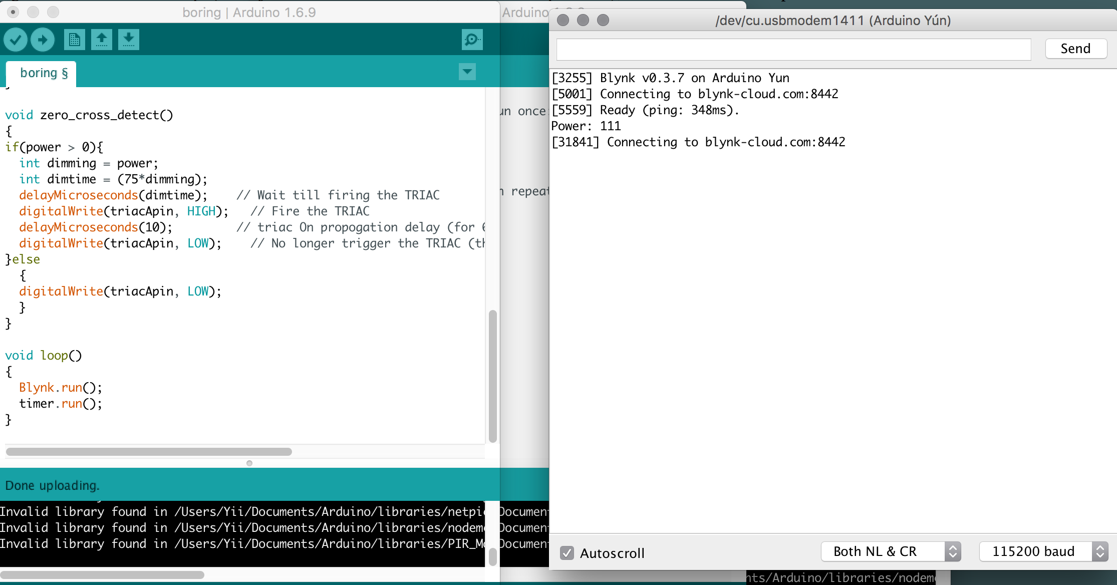

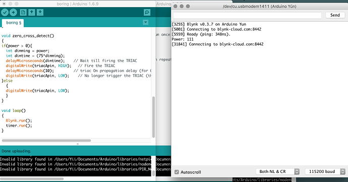

I would like to dim my LED light. Now my code can dim with Blynk but just only few minutes. I think i send data a lot to server and its kick from server Blynk. I don’t know why, coz’ i set interval time already. So please advise some hint to me. Thank you
#include <Bridge.h>
#include <BlynkSimpleYun.h>
#define triacApin 6
int power = 0;
char auth[] = "";
  Blynk.begin(auth);
  pinMode(triacApin, OUTPUT);
  digitalWrite(triacApin, LOW);
  timer.setInterval(1000L, zero_cross_detect);
  attachInterrupt(0, zero_cross_detect, FALLING);
BLYNK_WRITE(V1)
  Serial.print("Power: ");
  Serial.println(param.asStr());
  power = param.asInt();
void zero_cross_detect()
if(power > 0){
  int dimtime = (75*power);
  delayMicroseconds(dimtime);    // Wait till firing the TRIAC
  digitalWrite(triacApin, HIGH);   // Fire the TRIAC
  delayMicroseconds(10);         // triac On propogation delay (for 60Hz use 8.33)
  digitalWrite(triacApin, LOW);    // No longer trigger the TRIAC (the next zero crossing will swith it off) TRIAC

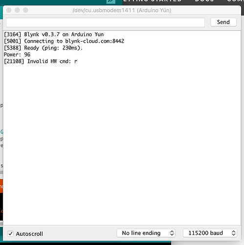

What happens after this few minutes? Code seems fine for me.
I can dim only one time then its stuck. Blink Server is reconnect. I don’t know why?

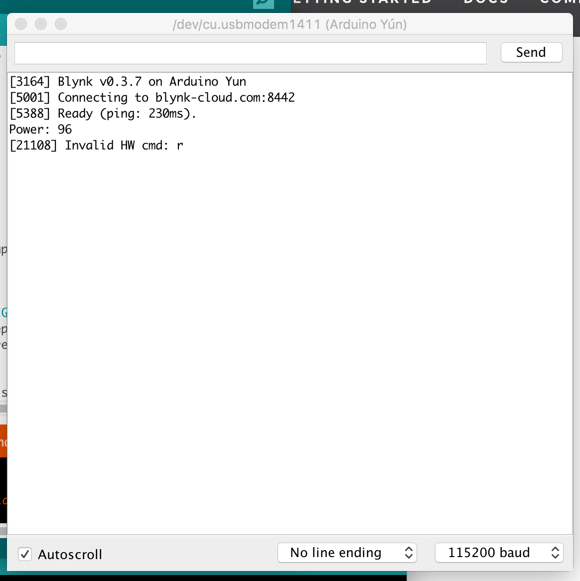

What error message do you see?
I don’t know what does it mean “Invalid HW cmd: r”
@vshymanskyy do you know what it could be?
Thank you for helping :wink:
The message means, in general, that you have somehow broken communication between Blynk Cloud and the device.
This may be some glitch, that appears because of high Voltage/Current electromagnetic spikes in you project.
