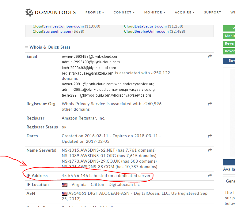

How can I do to find this Ip?
I access the website: http://whois.domaintools.com and paste this url: http://blynk-cloud.com
and result is 45.55.96.146

@VietLe which operating system are you using?
That might be the correct IP, it might not be.
Drop down into command prompt, dos, console or terminal, whatever you call it on your PC.
Then issue the following command:
ping blynk-cloud.com
thank you very much )) It’s done. thanks @Costas
I haven’t received a private message. Does ping give you the same IP as domaintools?
