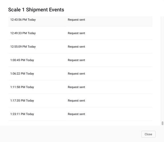

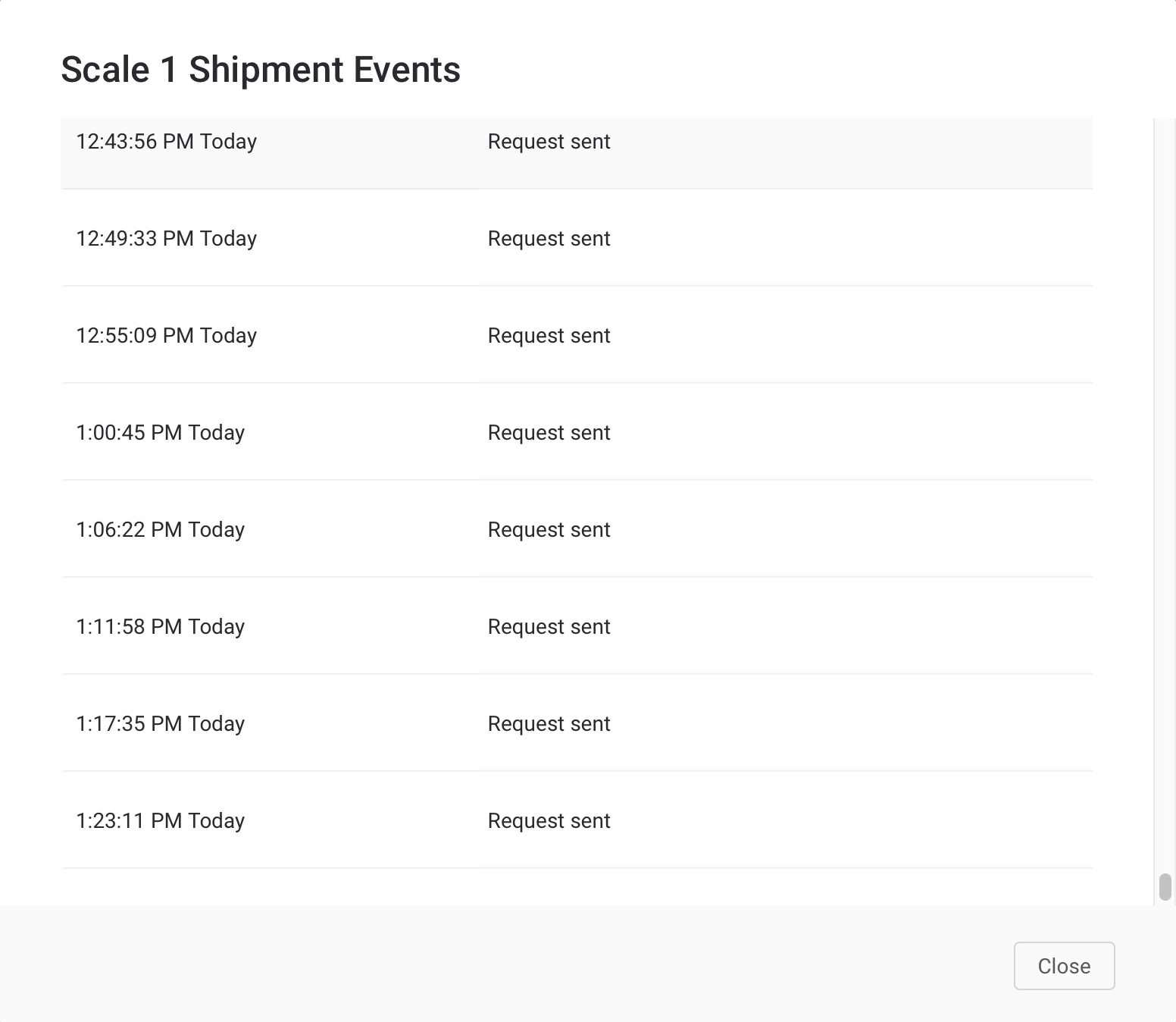

So it’s been 27 hours since I initiated the shipment. The controller sleeps for 5 minutes between logs. The shipment event log simply shows “Request sent” every 5 minutes since initiation (see screenshot). Is it normal to take this long?
-Newby
No, it’s not normal. “Request sent” means that when your hardware connected to the Blynk cloud - cloud send the request that there is a shipment for that device. The next step should be request of the firmware from the hardware. Looks like this is not happening. Probably because your hardware goes in deep sleep right after this?
@vshymanskyy please advise.
Yes, that should be the case.
