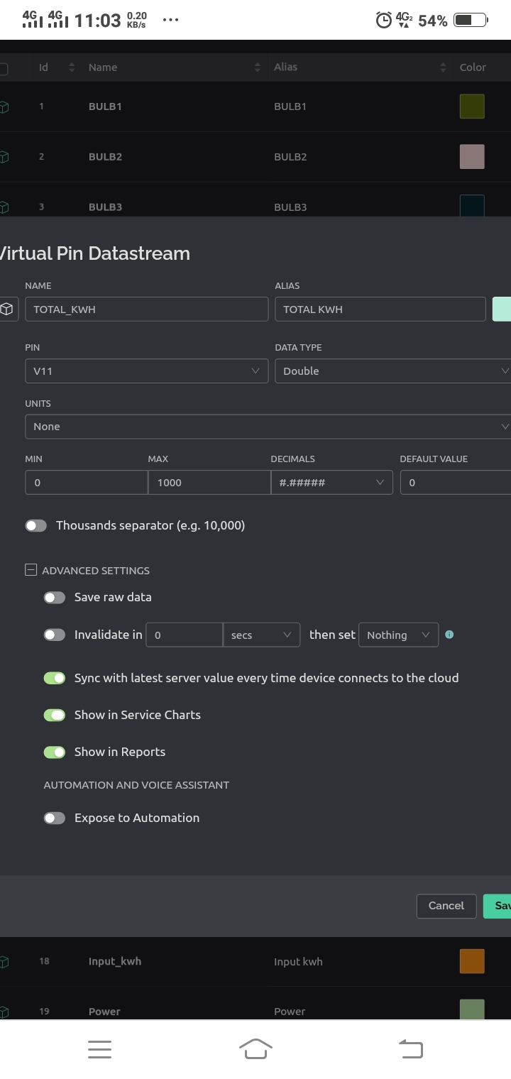

Exactly which virtual pin value(s) are you trying to synchronise, and how are those datastreams configured (screeenshots would help).

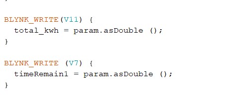

You need to add in a function to retrieve the value from the server.
For example:
 BLYNK_WRITE (V11)
kWh = param.asDouble();
Good day sorry for the late reply, the pictures below is part of my code (specific in retrieving kWh (V11)), and data stream.connected blynkwrite

Posting snippets of code doesn’t help us (and therefore doesn’t help you), especially when those code snippets are in the form of screenshots.
You’ve ignored this piece of advice…
so I’ll take a back step until you’ve done that and posted you full updated code along with the serial output and some narrative that explains what steps you took in terms of removing and restoring power and removing and restoring WiFi to go along with the serial monitor output.
