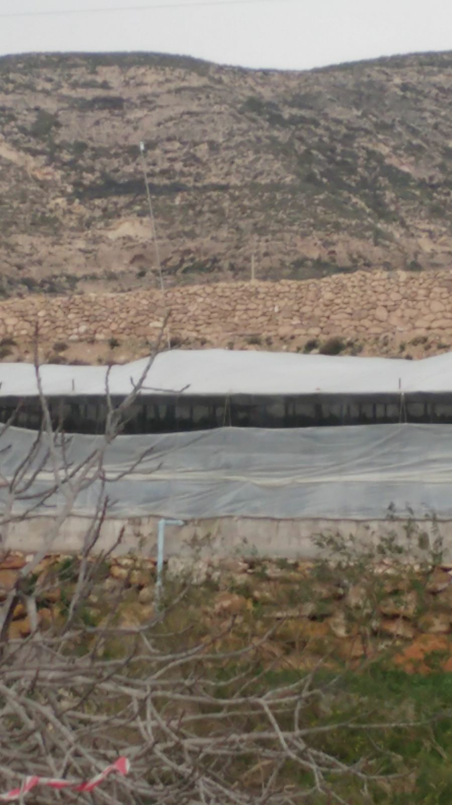

a) Where is the internet connection in relationship to the Greenhouse… approx distance, and is it in line of sight? (EDIT - OK, now I see the greenhouse antenna in the photo… way up there :wink: - does it get a good signal or do you need to upgrade the internet to greenhouse link as well as inside the greenhouse?)
b) Once in the greenhouse, How many estimated MCU’s do you need, and what does each MCU need to do (i.e. how many and what type of sensors for each MCU)
c) In every estimated MCU location, do you have power or are you also going battery operated??
a) From Home to Greenhouse raspeberry with blink server is there signal is perfect 100 mb connection it is private lan. I also use it as access point for connect wemos via wifi.
