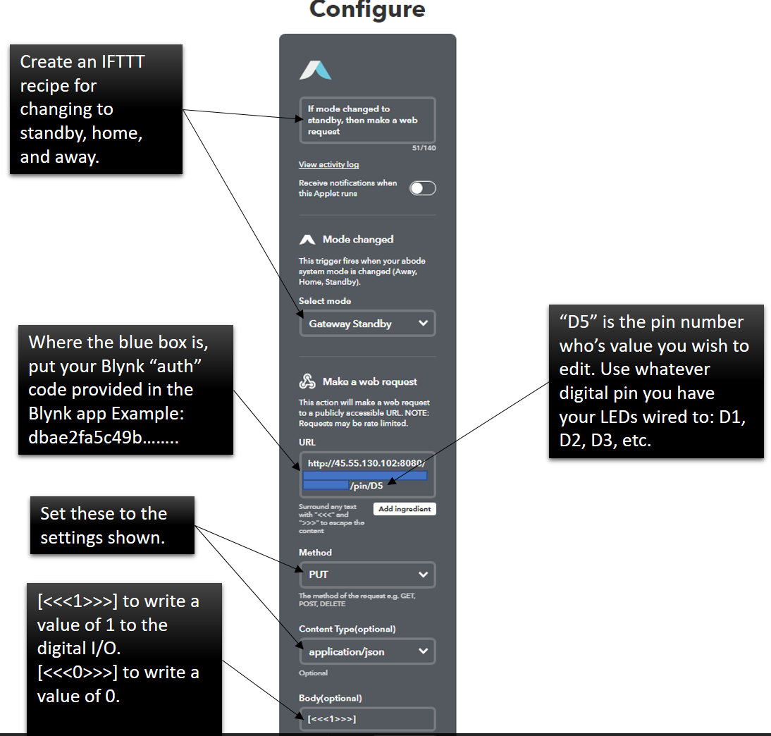

Step 4: IFTTT
I realize there is a better way to set this up, but this was my quick and dirty solution. You will end up with 6 total IFTTT for Abode. (This assumes you already have your Abode account linked to IFTTT.) The recipes will do the following:
- Turn on green led if system changed to standby.
- Turn off green led if system changed to home.
- Turn off green led if system changed to away.
- Turn on red led if system changed to home.
- Turn on red led if system changed to away.
- Turn off red led if system changed to standby.
