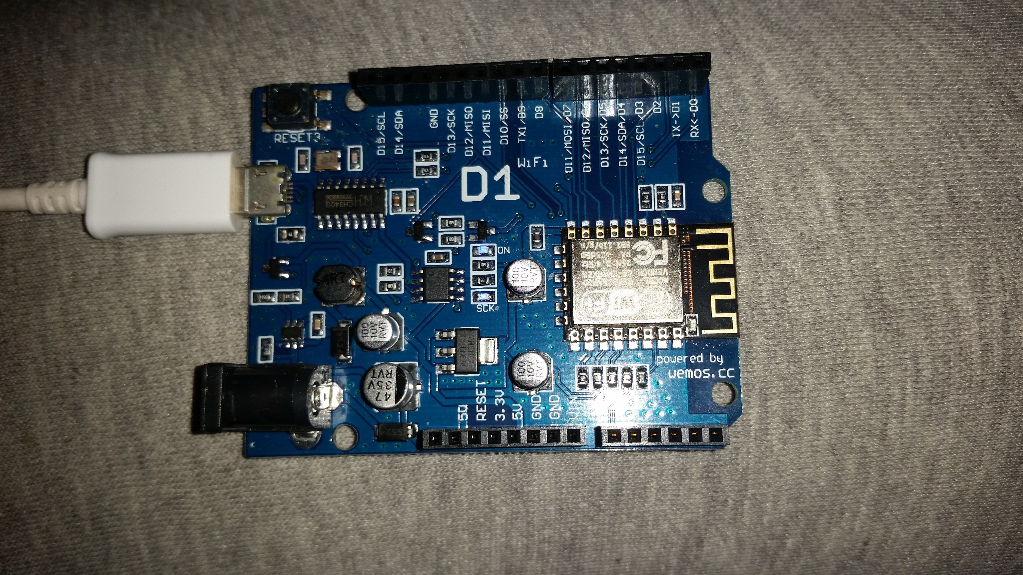

I have buy WeMos D1 board, but I can’t understand why it is periodical disconnecting. Disconnecting interval is about 1 - 3 seconds, then it reconnecting and disconnecting again. Like that is all time. I think code is simple as possible.

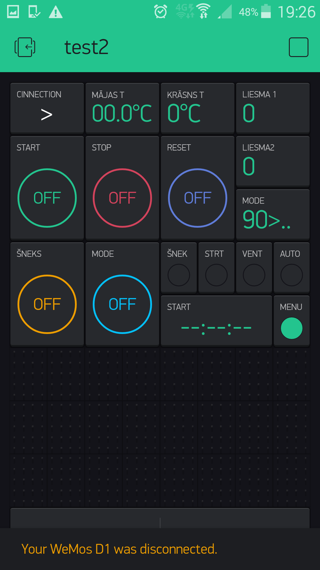

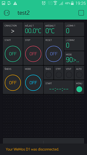

It is very strange, I live in place where neighbors is 300m away, so there is clear from any signals and this board I test near the router, there can’t be week signal. I also was try both, external power supply and power supply from USB (same lost connection). I have two WeMos boards, I have tested both - the same. If I use this simple connection see test then board longest connection time is 15sec usualy it is 2-3 sec. If I load more complicated code, then it was reconnecting every single read (read set to 1sec).
As there can see connection is not lost until I turn on my phone and start to read value evey one second.
[10317] Connected to WiFi
[10317] IP: 192.168.1.113
[10317] Blynk v0.4.0 on Arduino
[10317] Connecting to blynk-cloud.com:8442
[10438] Ready (ping: 1ms).
[127349] Login timeout
[127350] Connecting to blynk-cloud.com:8442
[127448] Ready (ping: 1ms).
[133665] Login timeout
[133668] Connecting to blynk-cloud.com:8442
[133765] Ready (ping: 2ms).
[139703] Login timeout
[139706] Connecting to blynk-cloud.com:8442
[139806] Ready (ping: 2ms).
[146633] Login timeout
[146634] Connecting to blynk-cloud.com:8442
[146736] Ready (ping: 3ms).
[153730] Login timeout
[153730] Connecting to blynk-cloud.com:8442
[153830] Ready (ping: 0ms).
[159778] Login timeout
[159780] Connecting to blynk-cloud.com:8442
[159890] Ready (ping: 0ms).
[166734] Login timeout
[166735] Connecting to blynk-cloud.com:8442
[166835] Ready (ping: 1ms).
[172700] Login timeout
[172702] Connecting to blynk-cloud.com:8442
[172803] Ready (ping: 1ms).
[180763] Login timeout
[180766] Connecting to blynk-cloud.com:8442
[180894] Ready (ping: 1ms).
[186811] Login timeout
[186813] Connecting to blynk-cloud.com:8442
[186917] Ready (ping: 0ms).
[192736] Login timeout
[192738] Connecting to blynk-cloud.com:8442
[192839] Ready (ping: 2ms).

I have previously run this example on my expensive Arduino WiFi module for an year it was working perfectly, but after update to blynk version 0.4.0 I can’t get connection with internet with this module (May be you can help me there too). It is why I buy WeMos D1 to test how it works with blynk, (I planing to use it in future to automatize all) because it is more times cheaper too. But now too no luck :pensive:
I use this board. I see that there on market is diferent look WeMos boards. May be mine is bad one chaise? Or may be there is need some hardware version update? It is just guess.
That doesn’t look like a WeMos board. Suggest you buy a WeMos from their store on AliExpress https://www.aliexpress.com/store/product/WeMos-D1-WiFi-uno-based-ESP8266-for-arduino-Compatible/1331105_32455782552.html
http://www.banggood.com/search/wemos.html

I’m using Rev2 boards
Check out the pictures on the Banggood site
There is a Rev 1 board that’s obsolete now
Then a Rev 2 board (that’s the ones I have)
Then a Rev 2.1 board which probably is not much different

That disconnect is so consistent it is like you are telling it to do it.
Try running the Blynk debug to see deeper…
It might be the case though that you wrote your project some time ago and Blynk changes to the server mean you are not connecting
Are the Blynk libraries up to date I had to replace the old ones with the new when reviving an older project from last year
Hi Janis
I think reads every one second might be causing the log offs you could try shifting that to once every 10 or more secs to check
I would think if it was the same when you were using the Arduino it should work but I would try it anyway
I have a project on here with 10 temp sensors being displayed in Blynk and I had to keep the displayed values read rate down to avoid being logged off
It still looks to me though that you are not getting logged on to the Blynk server
Set all app widgets to PUSH frequency!
Wherever you source your WeMos’ from I would suggest you only buy where you see the WeMos logo.
I don’t know what WeMos translates to in Chinese but the WeMos business seems to be able to protect their logo much better than the word WeMos.
So http://www.banggood.com/WeMos-D1-WiFi-UNO-ESP-12E-Based-ESP8266-Shield-For-Arduino-Compatible-p-1087347.html and D1 r2 v2.1.0 wifi module based esp8266 module geekcreit for arduino - products that work with official arduino boards Sale - Banggood.com sold out-arrival notice look like they might be genuine products and D1 r2 wifi esp8266 development board compatible uno program by ide Sale - Banggood.com looks to be fake.
Personally I wouldn’t buy from Banggood as WeMos’ official website only provide one link to their store and that is with AliExpress.
@Janis WeMos charge $6.50 plus delivery for their D1 boards with little or no discount for bulk purchases. They are also considered to one of the cheapest suppliers around. So you are highly unlikely to see a real WeMos D1 board on Ebay for $4.50 including delivery.
That said, many of the fakes do function reasonably well from what I have read.
Ignoring your full sketch and turning to your basic test sketch @Dave1829 is right you should look to use a PUSH frequency and SimpleTimer. 1000ms intervals are no problem for Blynk and even down to 10ms shouldn’t normally be a problem but most projects don’t need intervals below 1000ms.
Most regular Blynkers only use PUSH frequencies and they have their reasons for this.
This is the defacto example you should use to test your “WeMos” (but change the Ethernet libraries to ESP etc) and it appears in the Arduno IDE https://github.com/blynkkk/blynk-library/blob/master/examples/GettingStarted/PushData/PushData.ino
If this fails to stay connected then I think you can put the “WeMos” in the bin. If it does stay connected let us know and we might be able to find the problems in your full sketch. If your full sketch is not using PUSH frequency for all applicable widgets you should consider changing them.
Good point Costas
Regards buying a Wemos
All the pictures of the boards are on the same webpage at Banggood so it was just to help identify the board I haven’t heard of a Rev3 although there may be one
Thank you all for help! I have set all data to push and use Simple timer, and now it works fine. I have find also that can’t be pushed data for 4 led at once, then it disconnecting again. I have usetimer.restartTimer(); to separate all data to not push all data at once but in different times with step of 150 milliseconds. And now it works fine!

Well done Janis and thanks for coming back with the solution
