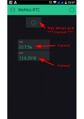

As you can see in the attached picture, at Android Blynk App, I can see correct date and time updating just fine at the specific Value Display widgets. No matter how long I have waited, never, never saw RTC widget shows something different than the analog clock logo on it.
Is there something to do in order to have RTC widget shows time/date on it???

RTC widget is used to enable the functionality. Similar to Notifications and Twitter.
It doesn’t show the time. It’s just an icon
