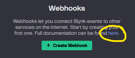

People should at least put the documentation link to it on the same page.
I checked there, there is no real explanation about my questions.
