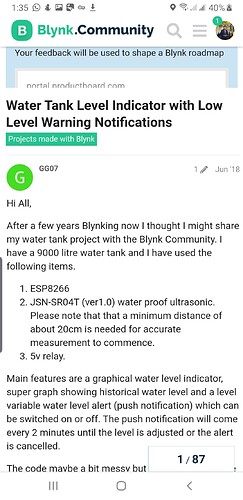

A very nice project. We have a tank about 100m from the cottage. Unfortunately it’s through forested area so a straight run with an ESP probably won’t work. I initially tried with an NRF24101. That worked only in spring when there wasn’t much foilage. Did manage to get a working system with a Ra-02. Works great. I’m hoping to make a gateway on the receiver end and incorporate your project to send data to my cell phone. That would be great. BUT I’m having a bit of problem with the code. First of I’m using a ESP8266 12-E NodeMCU which might be the problem.
The code works and sends to the Blynk. But the Vertical widget always shows full (Green). I know it’s working because if I pull the voltage wire off the sensor it goes to zero (dark), so it’s got to be the ultrasonic program that’s the problem. I’ve tried different the code inputting different boards (Generic ESP8266) and NodeMCU 0.9 (ESP 12 - Module) with same result. Have the virtual pin set to V12… So I’m thinking the program might have been desigined with another board in mind…
any suggestions?
Jeff
Hi Jeff, did you test the sensor before installing it I to the water tank to ensure its measuring correctly and also if I remember correctly if you use v12 on a labeled widget you should get a distance measurement… Have you tried this?
Regards
G.
Hi G:
Got it working now using a gauge widget. I’ll try and get it working with a chart like yours to monitor water usage. One thing I’ve been looking for but not able to find is an alarm to signal a sudden drop of water - say a broken line. What I’m trying to find or create is an ā€œifā€ statement that states that if there is a drop at any time (or depth) of 6" in two hours or less than trigger the relay. It sounds simple, but it’s a bit more complicated because of having to be a change of depth over time. It couldn’t be just from the initial depth of the tank (say full), but at any depth because the tank could be down because of normal usage. Any thoughts?
