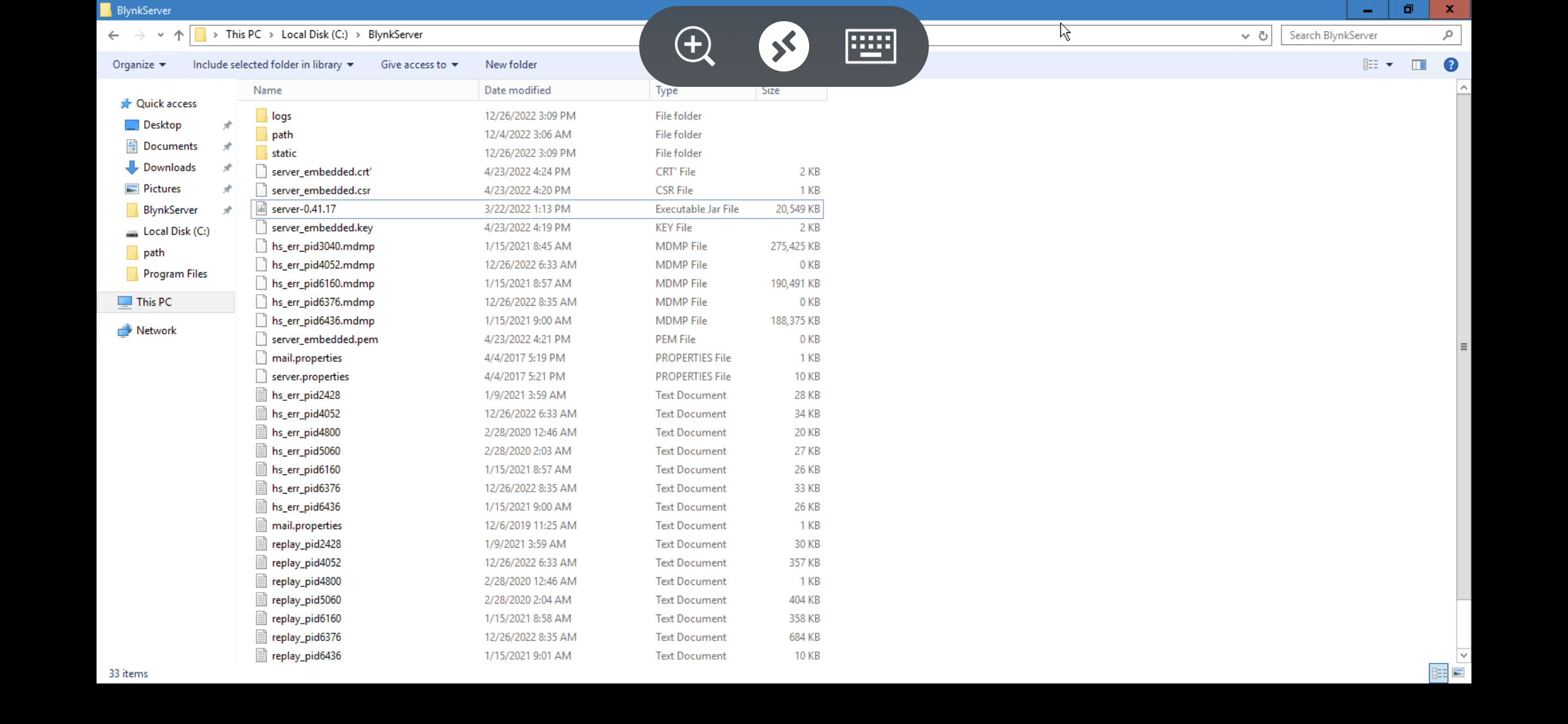

Why do you have so many versions of the server.jar file on your system?
What command are you using to launch the server?
You’d normally launch the server with a batch file called start-blynk.bat and the contents of that batch file would normally include full server .jar file name (with version number in the file name) and a switch to tell it the location of the data file.
Also, you really ought to be running version 0.41.17 of local server.

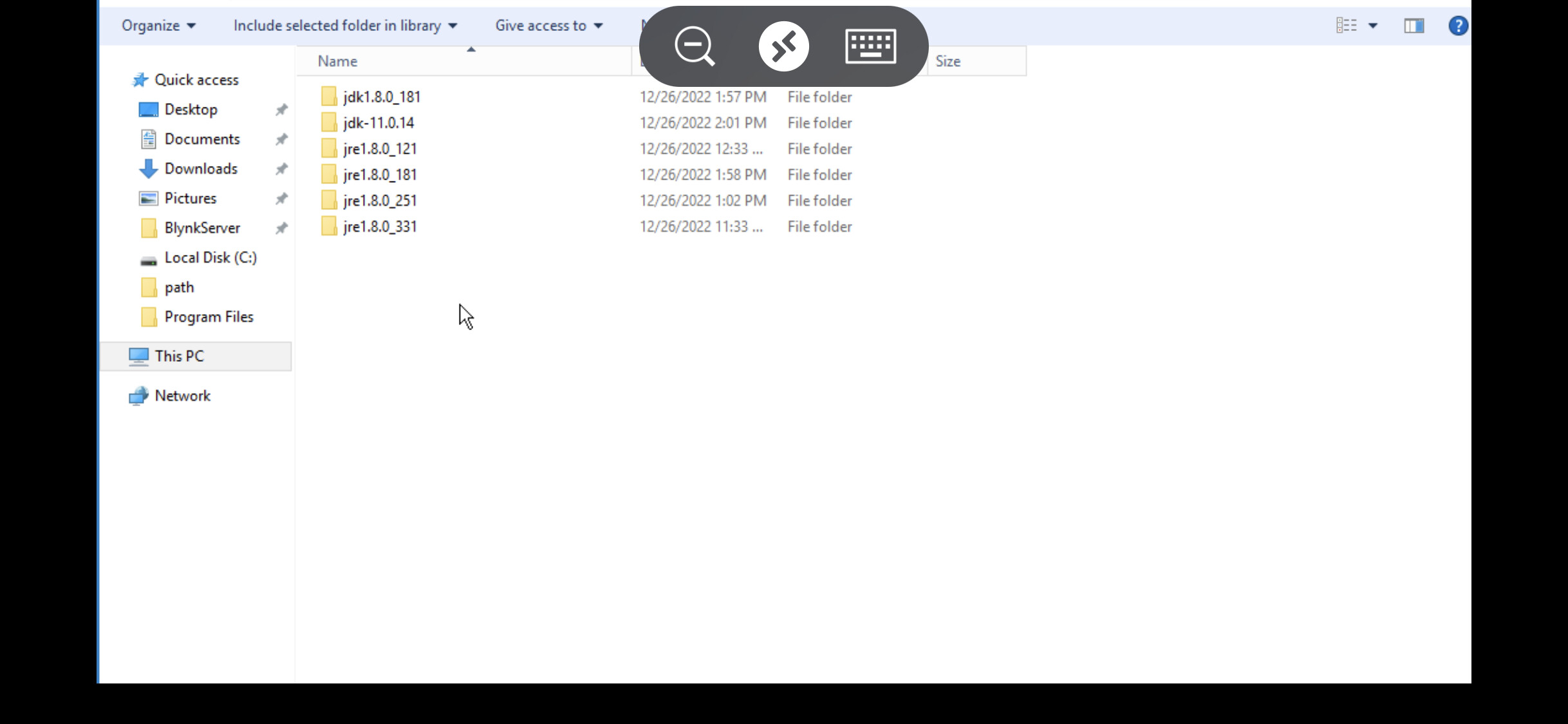

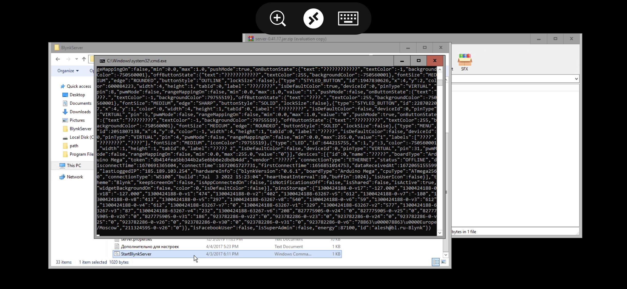

Здравствуйте, после установки версии которую вы указали, я пробовал разные версии, пробовал оставить один файл в папке blynkserver, в любой версии выводится ошибка.
