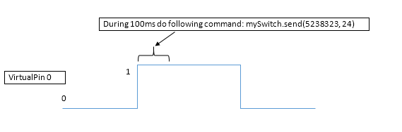

Thank you for your answer. I spent all Sunday to read about SimpleTimer, Virtual Pins, 433mhz and IFTTT. I think that IFTTT is no problem now for me, but I can`t find the way to do something like on this picture:
v0
I found your answer in another post, when you suggest to use such commands:
BLYNK_WRITE(Vx) { // when Button Widget or Web API called
  if (param.asInt() == 1) {
    digitalWrite(6, HIGH);
    timer.setTimeout(100L, []() {  // reset pin in 100ms
      digitalWrite(6, LOW);
But in my case I would like to send some RF code and I don`t know command how to send “release button” after 100ms and no longer send “mySwitch.send(5238323, 24);”.
