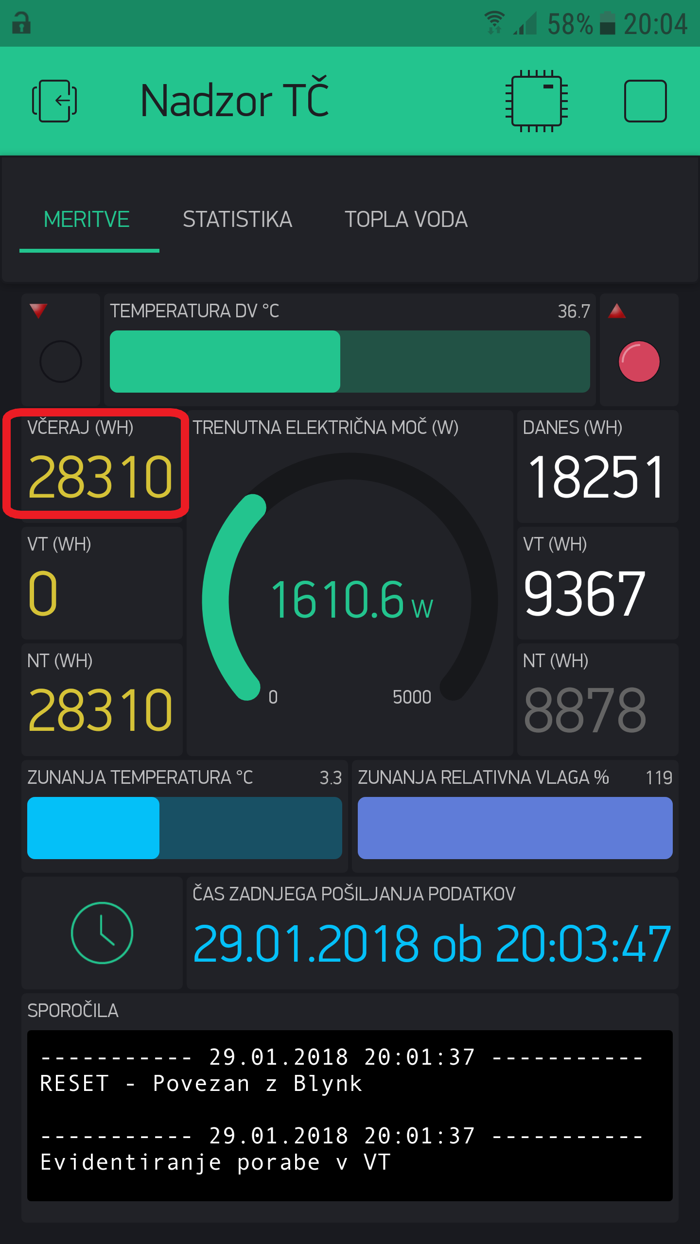

Yes, this data is visible on my phone. When date is changet (new day), program write daily elektricity consumption as yesterday consumption. I check thise values every day on phone and they was always there.

It is Value display, connected with V16. Same situation with V26 and V36.
Today I try to get history values again. But I got only three values, same as yesterday. This is my application, with marked value of yesterday consumption.
