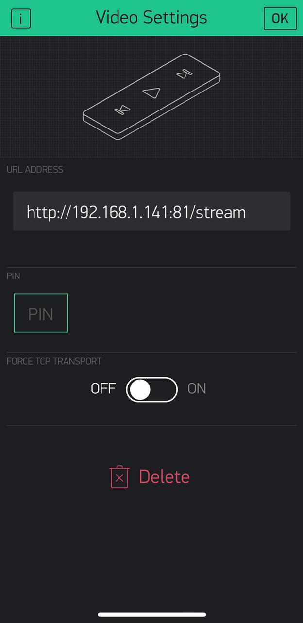

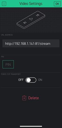

Im using the link
http:// x.x.x.x:81/stream

I’m not using an Auth token on the ESP-32 cam since it gives me a LAN link http://192.168.1.141/
and what do you mean by the correct device selected in the video widget?

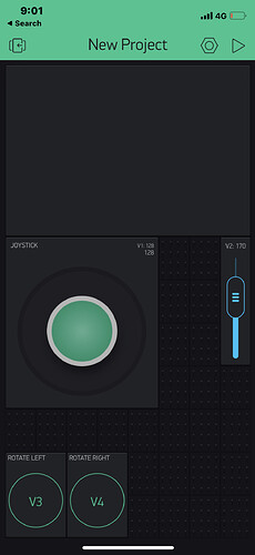

this is what I get in my Video widget.
It doesn’t work. I spent a lot of time with and ESP8266 and ESP32-CAM sending an mjpeg stream and there is no solution apart from splitting the phone screen and running Blynk in one half and the a web browser in the other half with the video. I guess the Vdeo Streaming widget is buffering the stream and the buffer is two small and as a result cannot keep up even with QVGA.
As an aside I set up a RPi zero as an access point and a local Blynk server. It worked fine until I browsed to the video stream then the Pi fell over even though the network stayed up. I think the problem is that the RPi is to slow to route a video stream along with its other tasks.
You should probably join the Beta programme (done in Playstore) and download the latest Beta version (2.27.1- I think).
You should also update your local server to the latest version (0,41.15 I believe).
There have been some significant changes to the video widget in the beta version of the Android app.
