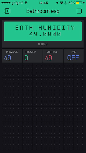

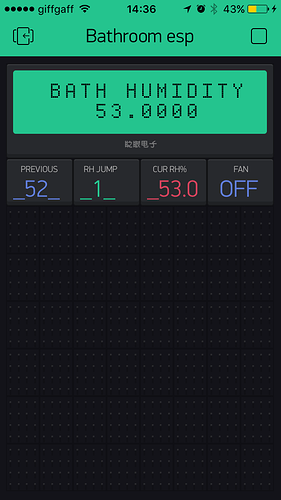

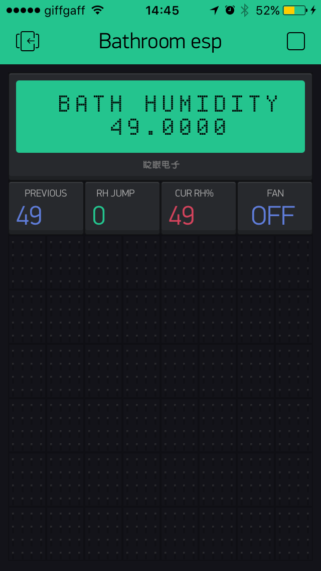

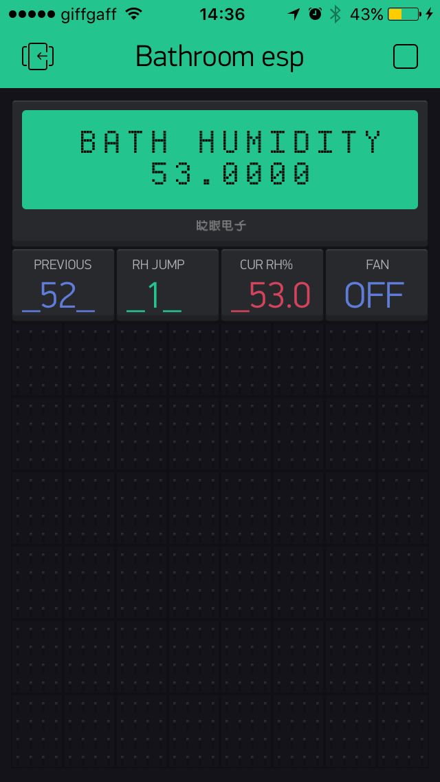

Being a bit fussy I wanted to show a variable in the middle of a value display widget on my dashboard rather than the standard left side so I converted it into a string and added a space to move the display to the right by one character
String hs = String(h);String hss=(" "+hs);
Blynk.virtualWrite(V2,hss);
This is the output on the app
but the space is ignored🤔 If I replace the space with an underscore it moves to where I want.
Any thoughts on how to solve this?
I’m very new to c programming so any help appreciated :+1:
