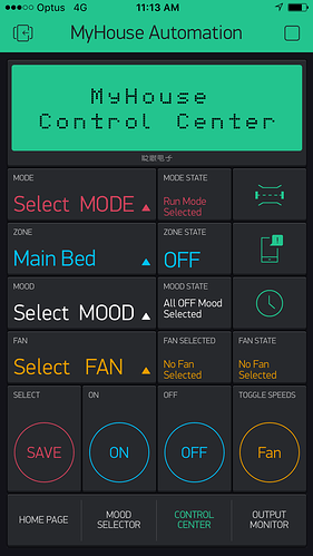

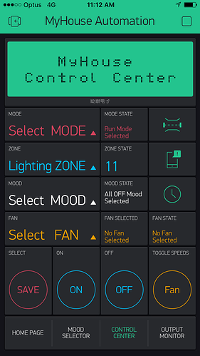

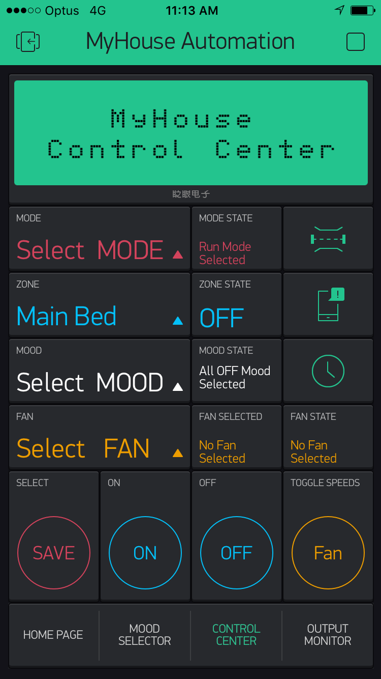

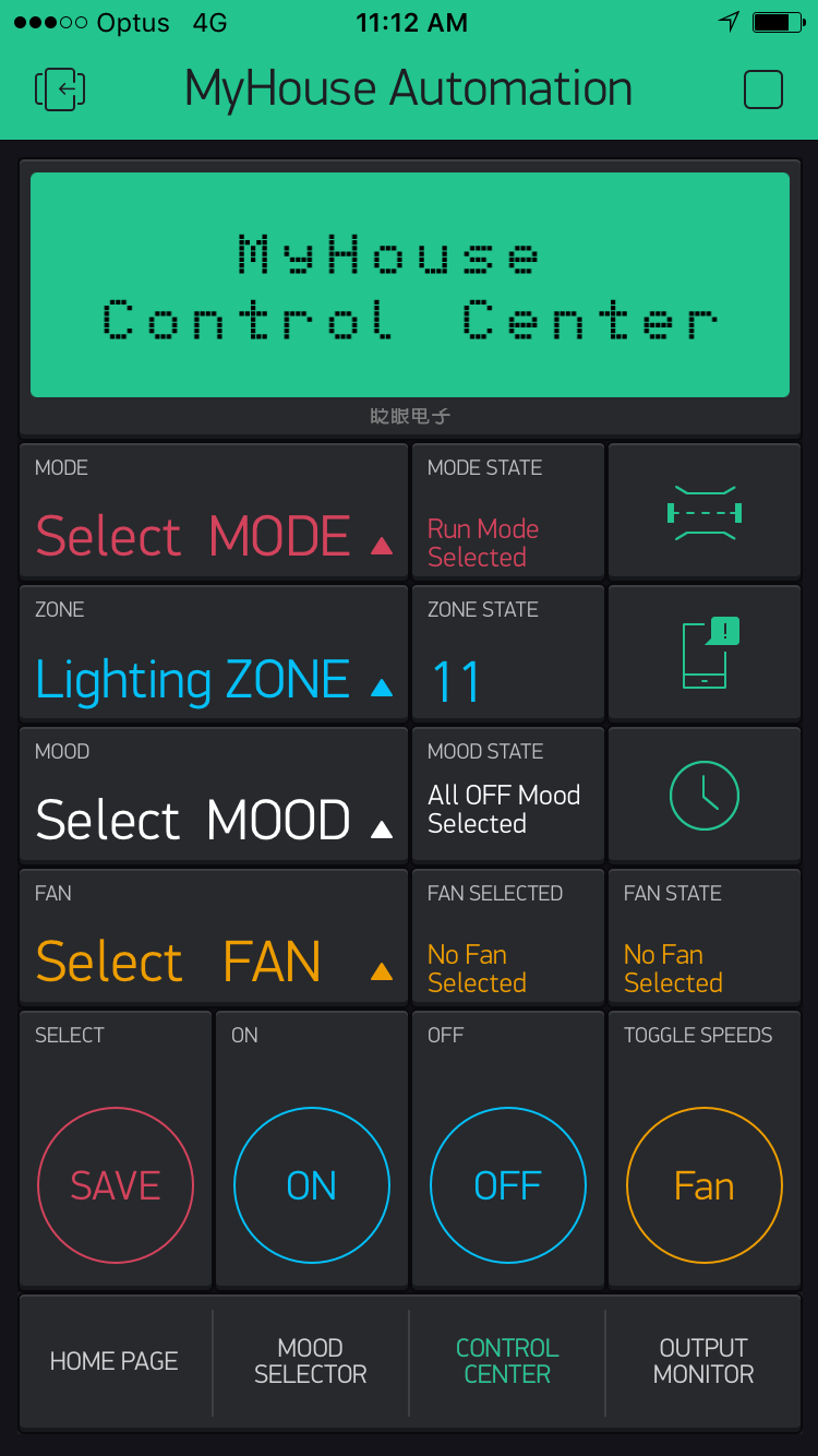

@NickMurray can you post a couple of photos then. One with correct text and one showing “11”.

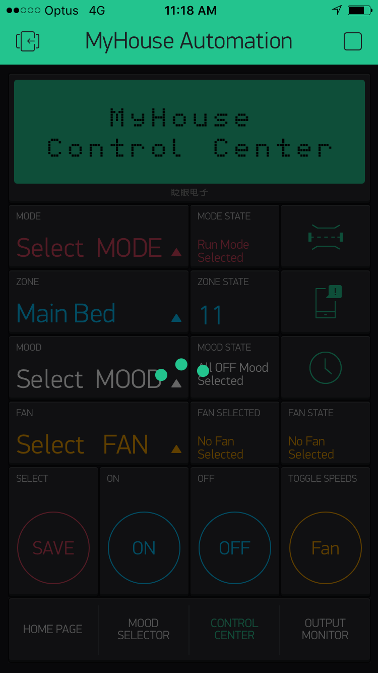

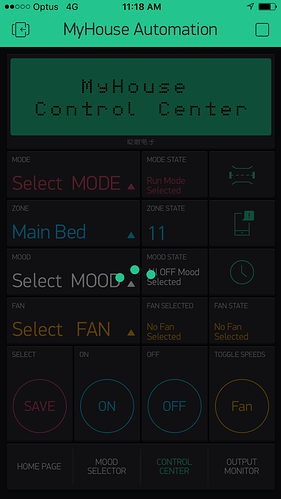

So the 11 always appears after these dots juggle around for about 6 seconds. Then if I press stop then play on the app the correct text is displayed
