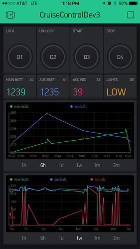

Value display bit map not transferred to history graph
Is there a way to get the history graph to use the same bit mapping as the value display? I have scaled the bits to read as voltage in my value display but the history graph only reads bits. Is this something that will be implemented in the future? Can i get the value to display the correct decimal placing for volts instead of mV?
I have tried to do the mapping on the Photon but i’m so confused. Mapping virtual pins sounds so easy but i cannot find any examples using the photon that make any sense. All the examples use arduino libraries except for the one Pavel made for temp and humidity with a core but even that uses a sensor library that i’m not implementing.
Also, the way i’m using Blynk does my data only log when the app is open? sorry for all the noobie questions

void setup(){
updateTimer.SetCallback(OnTimer);
delay(5000); // Allow board to settle
pinMode(A0, INPUT);
pinMode(A1, INPUT);
pinMode(A2, INPUT);
Blynk.begin(auth);
void loop(){
updateTimer.Update();
void OnTimer(void) { //Handler for the timer, will be called automatically
// read analog ports
mainRaw = analogRead(A0);
auxRaw = analogRead(A1);
accRaw = analogRead(A2);
main = map(mainRaw, 0, 4096, 0, 1865);
aux = map(auxRaw, 0, 4096, 0, 1865);
acc = map(accRaw, 0, 4096, 0, 1865);
main = (main / 100);
aux = (aux / 100);
acc = (acc / 100);
Blynk.virtualWrite(3, main);
Blynk.virtualWrite(4, aux);
Blynk.virtualWrite(2, acc);
