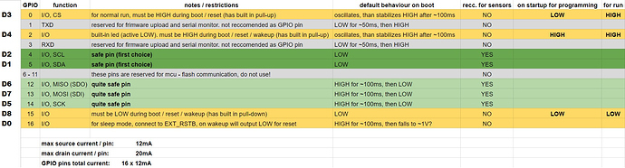

Aside from GPIO0 (D3) which has a built in pull-up resistor and thus should probably be avoided for your relay purposes. This should work as desired…
Blynk button ON = digital pins ON
Blynk button OFF = digital pins OFF.
What is your exact issue?
PS, it is better to use the GPIO numbering in your code, not the Dx silkscreened designations… and to use the green pins (below) first before others…
PPS, If your relays are Active LOW (AKA relay turns ON when sent a LOW signal), then you should reverse the button action on either your Widget settings or in the code.
