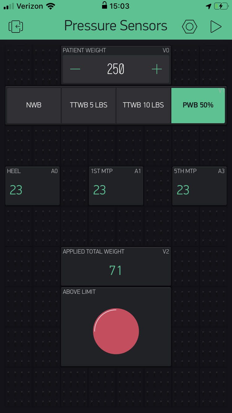

I found Blynk recently to help build a project and found some issues. I’m using Blynk onr a Particle Photon running 1.4.4 firmware and communicating wifi, and using iOS on the Blynk Server.
I’m reading analog data from 3 weight sensors A0-A3, then having those values, for the moment, being read directly by Blynk. No issue there.
From there, those values are added together to give a Total Weight, which works well.
Using 3 virtual pins, V0,V1, V2, I’m allowing user entry of pounds, displaying Total Weight, and displaying an alert LED, respectively.
The Virtual Alert LED should only go off when the selected setting on the segmented switch is used in conjunction with the Total weight, so if totAna >0, 5, 10, or 25% of the entered weight from V0,
Physically, I have a single LED (light1) wired to D0 to go off at the same time as led1.
I’m not sure if my segment is running correctly, and both LEDs stay on, despite the criteria not being met.
Any help would be appreciated to get this working.

When the segmented switch is set to 0 (NWB), any sum of the 3 sensors(as shown in Applied Total Weight) going over 0 should make the led1 and light1 light, then clear when value is zero. I say zero, the sensor will have some bouncing around, but that i’m not too worried about.
When the segmented switch is set to 5 (TTWB 5LBS), any sum of the 3 sensors is greater than 5, led1 and light1 light, and then clear when below 5.
Same for when set to 10 (TTWB 10 LBS).
When set to setting 4 (PWB 50%), which should look at V0 (Patient Weight) data entered, then calculate 25% of that, then when the sum of the 3 sensors is greater than calculated value, it should light up everything, then clear when the condition is not met.
V3 is an alert LED, ABOVE LIMIT, that triggers based on what criteria is set on segmented switch.
I’ve gone through and edited it with both your recommendations, I’m just not sure that the V0 is being processed correctly, and the led1/light1 stay lit, and APPLIED TOTAL WEIGHT (V2) stopped updating. Any insight to that?

You can manually enter a value, and it updates correctly, but why does TTWB only update after a momentary switch from option 4 to any other position, back to option 4?
Also, virtual pin V2, tied to a Labeled Value in the Blynk app, titled Applied Total Weight, should be receiving the value totAna, or the Total ANA being seen on serial. What would be the correct way to push this to the app?

  1. but why does TTWB only update after a momentary switch from option 4 to any other position, back to option 4?

Thank you again @PeteKnight and @khoih. It calculates the new TTWB after the value is incremented by the - or + or typed in with no issues.
What I’m running into now is this:
TTWB = 80
Total ANA = 1
TTWB = 80
BLYNK_PIN_TTWB selectedSegmentedSW = 2
Total ANA = 0
TTWB = 80
Total ANA = 0
TTWB = 80
poundValue = 319
TTWB  = 5
Total ANA = 0
TTWB = 5
Total ANA = 1
TTWB = 5
So the TTWB updates only after incrementing the poundValue up or down, doesn’t matter, then it works as it should? It seems I’m missing something to get it to refresh TTWB somewhere after.
I’d suggest that you re-read my last post.
