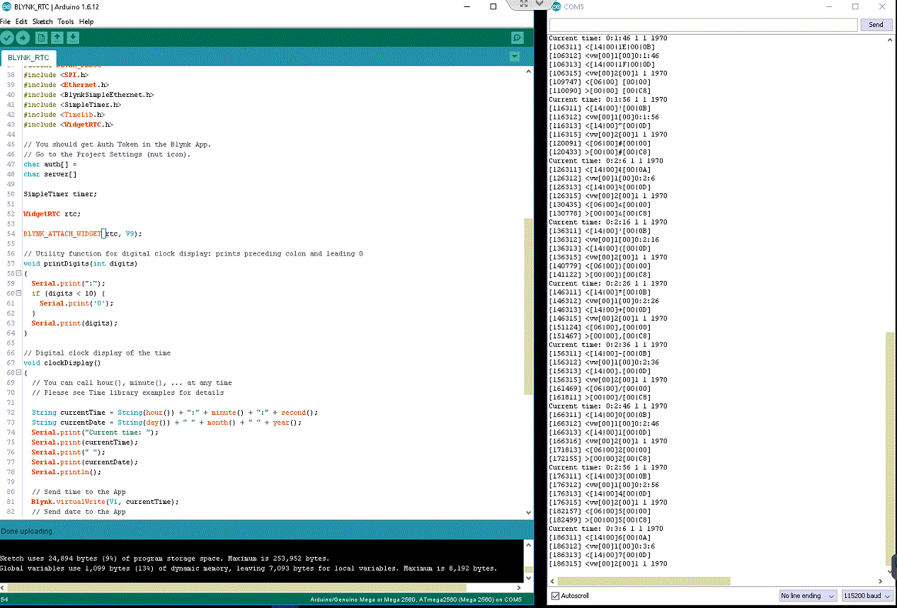

After update to master, my RTC widget doesnât work, on my own sketch, before update to master, RTC widget working, I saw on serial monitor log: âTime sync: OKâ, after interval of time, it sync again. After update to master today, I didât see that log. I tried RTC Widget example, this is my log on serial monitor
Sorry there were some RTC-related changes just yesterday, so maybe something got messed-up.
Iâll check it ASAP. Does Bridge work as expected?
Bridge work perfectly

is RTC widget fixed? It seems Blynk Table Widget on Raspberry doesnât work, I see only âaddâ was send from hardware, that widget is not support yet?
Yes, RTC is fixed⌠Please do not bloat the same thread with off-topic questions - create another thread if needed (after searching for the existing topics).
