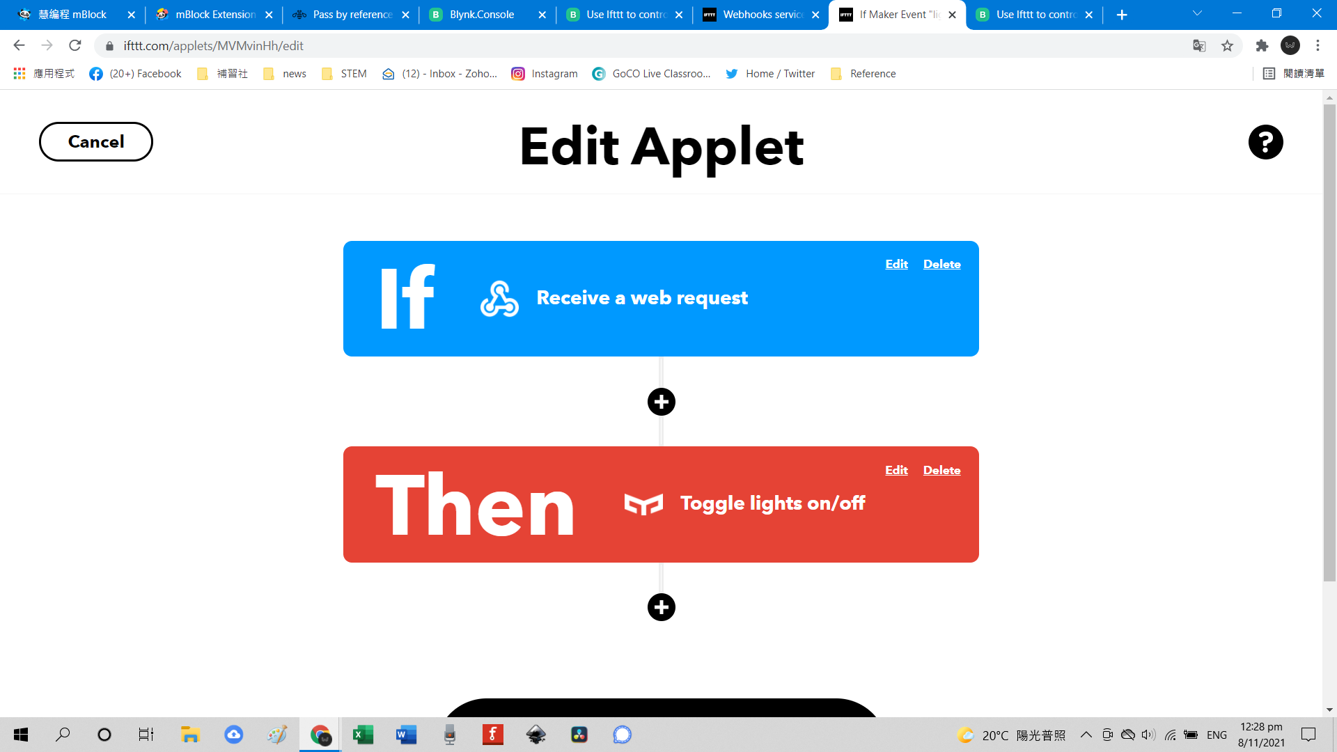

Show me how did you configure ifttt please
what do u mean about this??
A screenshot
this??
from Dmitriy, it said it can be trigger through this code. and I do can unless i changed those order.
