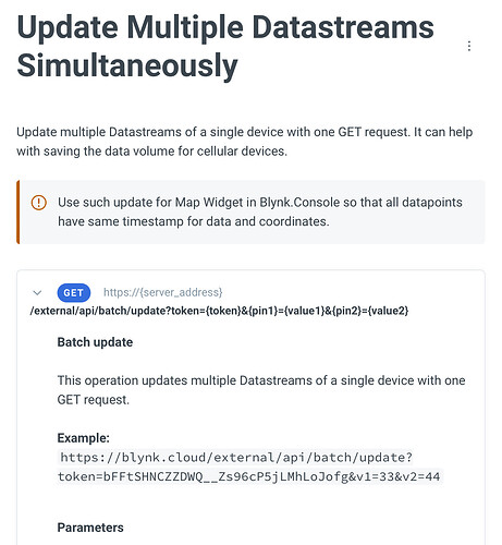

I guess you could use the “update multiple datastreams” or “batch update of datastreams” HTTP(S) API, but that’s a bit messy from within a C++ sketch
Yes, I saw this possibility in the documentaion but there is no any example, do you have any useful link
Thanks
