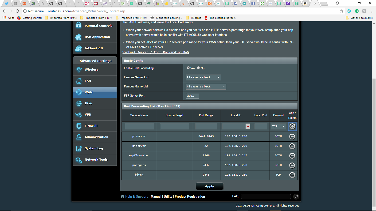

Sorry, I’m quite confused as well. Updated server to 0.30.2, changed app.ssl.port=9443 (was 8443 before), changed port of custom local server in Android app to 9443 as well, changed port forwarding in router from 8443 to 9443, but cannot log in in android app version 2.18.0. It says “Connecting” for ever. After changing port numbers no problems with my second tablet and android app version 2.17.2.

Are you sure?? I had to do that to allow my one phone, that was connecting via my No-IP DNS address, in order to connect to my Local Server… otherwise I just got a connection error.
I don’t need to be sure. I know that :slight_smile:. Updated app will connect to 9443 by default.
Exactly… which is why the change from 8443 to 9443 in my port forwarding tables that redirect incoming WAN connection (from my App, now on 9443) to my LS’s IP… but you are recommending to Jamesir that it is NOT required and to revert back to 8443 (in his routers port forwarding)?
But with new app 8443 is no longer used and for old apps this will not work.
I think we are saying the same thing… only in different internal languages :stuck_out_tongue_winking_eye: Remember we are talking about the users router (and it’s internal port forwarding)… NOT the App or the LS app.ssl.port.
The only thing you need to change with new app and new server is forward 9443 to your local server instead of 8443 for the app to connect to your local server.

Thank you for all your answers. It’s working now! Reverted app.ssl.port=8443 in server.properties file. Forwarded port 9443 in my router to local Blynk server on my raspberry to get WAN access from outside my home network, set 9443 in 2.18.0 Android Blynk app and that was it.

After the latest Android app update both my phone and tablet could not connect and I had to logout and login again. The new app version automatically connecting to the new port explains this as I didn’t have my router forward 9443 to the Blynk server.
