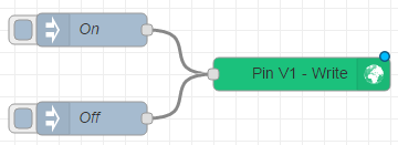

Try this flow:
[{"id":"1cc59b92.2d3664","type":"inject","z":"22ab1451.c65d5c","name":"On","topic":"","payload":"1","payloadType":"str","repeat":"","crontab":"","once":false,"x":470,"y":340,"wires":[["5d68415.851e1c"]]},{"id":"f657eef2.03214","type":"inject","z":"22ab1451.c65d5c","name":"Off","topic":"","payload":"0","payloadType":"str","repeat":"","crontab":"","once":false,"x":470,"y":420,"wires":[["5d68415.851e1c"]]},{"id":"5d68415.851e1c","type":"blynk-websockets-out-write","z":"22ab1451.c65d5c","name":"","pin":"1","client":"2fa4f650.84b19a","x":660,"y":380,"wires":[]},{"id":"2fa4f650.84b19a","type":"blynk-websockets-client","z":"","name":"Test","path":"ws://YOUR_SERVER(local, blynk):8082/websockets","key":"YOUR_BLYNK_KEY"}]
You need to inject string value to project virtual port. This value will be send to mobile application and also to connected hardware. But after some checks, this value is transmitted only to app and no to the hardware. Maybe I’ve something wrong.

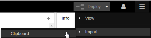

Use flow I’ve posted before, import it:
Update blnyk connection and then click on blue squers on injects nodes.

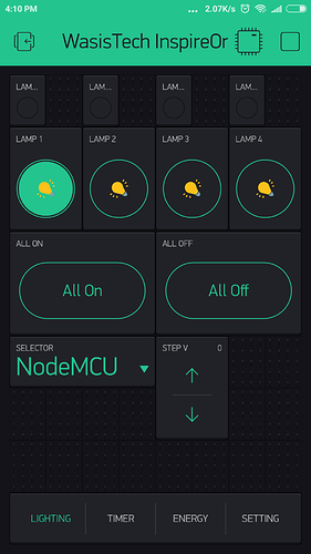

This is my flow
[{“id”:“ccc78c3d.b1c46”,“type”:“inject”,“z”:“ea506f02.55213”,“name”:“On”,“topic”:"",“payload”:“1”,“payloadType”:“str”,“repeat”:"",“crontab”:"",“once”:false,“x”:270,“y”:126,“wires”:[[“56bab128.19766”]]},{“id”:“cb4140a0.27a7f”,“type”:“inject”,“z”:“ea506f02.55213”,“name”:“Off”,“topic”:"",“payload”:“0”,“payloadType”:“str”,“repeat”:"",“crontab”:"",“once”:false,“x”:270,“y”:206,“wires”:[[“56bab128.19766”]]},{“id”:“56bab128.19766”,“type”:“blynk-websockets-out-write”,“z”:“ea506f02.55213”,“name”:"",“pin”:“22”,“client”:“54b96cd1.f23f04”,“x”:460,“y”:166,“wires”:[]},{“id”:“54b96cd1.f23f04”,“type”:“blynk-websockets-client”,“z”:"",“name”:“WASISTech InspireOne”,“path”:“ws://blynk-cloud.com:8082/websockets”,“key”:“mytokenkey”}]
button on Blynk android app is on but it is not trigering BLYNK_WRITE(V22).
Thanks for your help.
HW is not triggered by changes coming from node-red via websocket. I’ve found this problem last week too. Resolution is using Syncing. In HW I’ve implemented function like this which is periodically triggered (by timer etc.):
MyTimerHandler(){
    Blynk.syncVirtual(V22);
